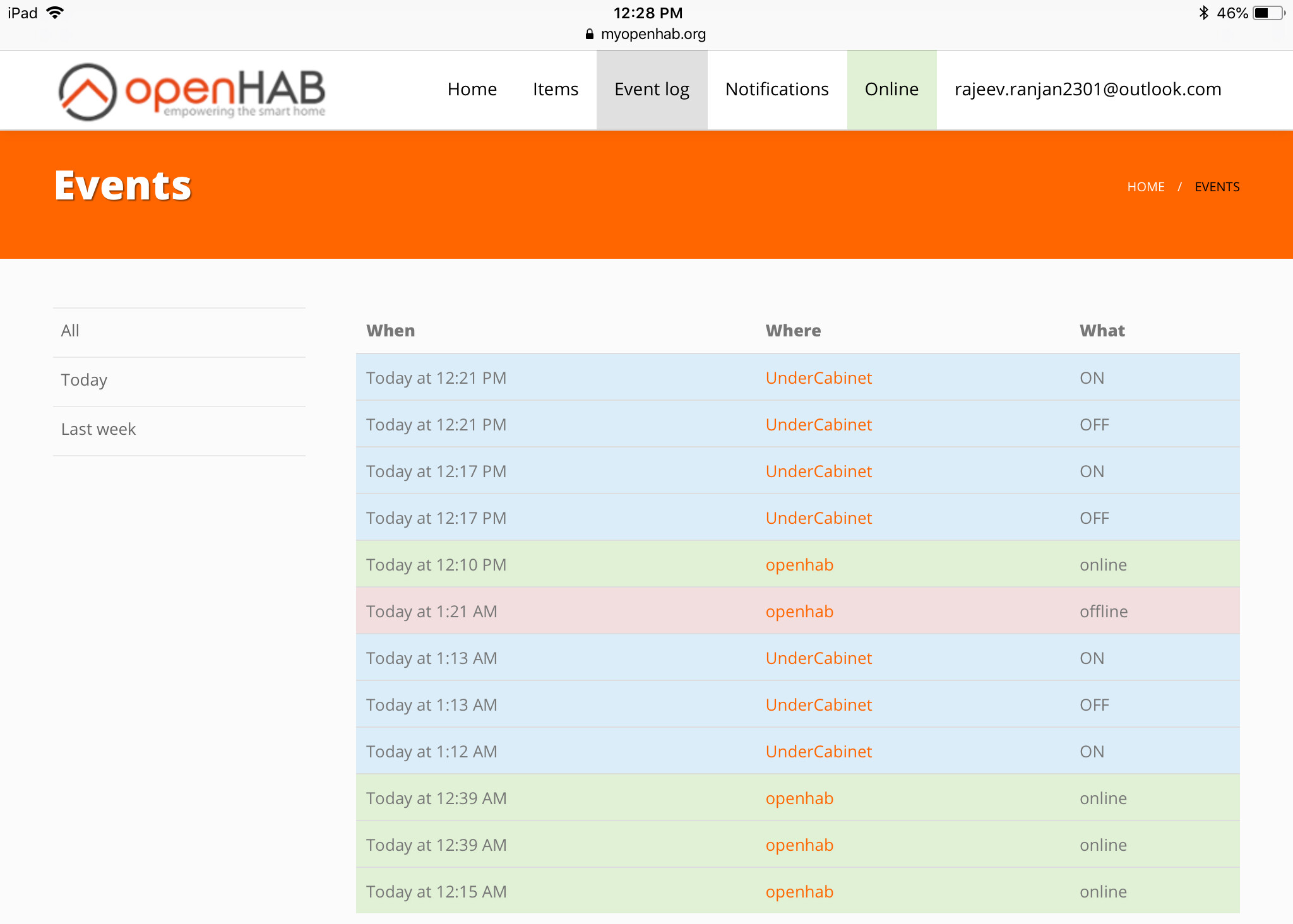

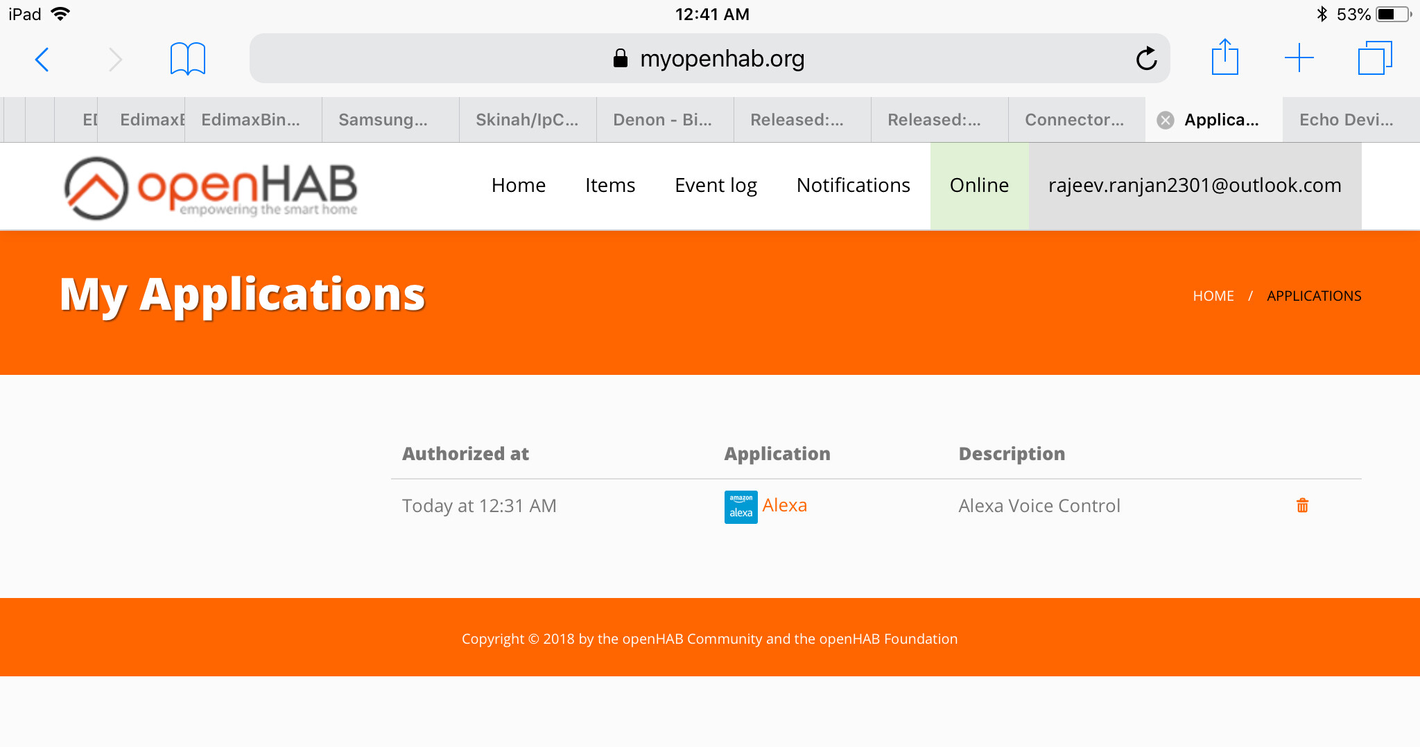

Thanks Sihui,
I followed the process as you suggested. However , I am not able to establish the connect. Please ref to the screenshot. It is endlessly waiting for the connection or throwing a SSE subscription error.
I can see through myOpenHab.org portal that it is connected with Alexa skill not sure where is the problem.
My item file just contain a simple line
Switch UnderCabinet   “UnderCabinet”<light>  (UnderCabinet) [“Switchable”]
image image image
Make sure you are using the correct quotes and don’t forget that empty space, then let Alexa discover your item again:
Switch UnderCabinet "UnderCabinet" (UnderCabinet) [ "Switchable" ]
Either you have the wrong quote sign or that did happen when you posted your code without code fences:
" instead of ”
