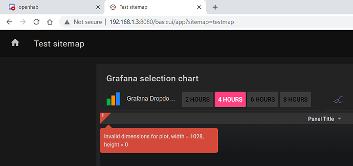

What does “&kiosk=1” do? I am trying to display different duration of the grafana chart but I am getting this error: error parsing query: invalid duration.
But it works fine when I refresh the page. Can someone please help?

What is the syntax you used for the duration? Share the entire link.
item:
String Grafana_Dropdown "Grafana Dropdown"
sitemap:
Frame label="Grafana selection chart" {
        Switch item=Grafana_Dropdown label="Grafana Dropdown: " icon=chart mappings=[1="2 Hours", 2="4 Hours",3="6 Hours",4="8 Hours"]
        Webview icon=line url="http://192.168.1.3:3000/d-solo/IM_GjMmRk/test-temp-and-humidity?orgId=1&panelId=2&from=now-2h&to=now&refresh=2s" height=14 visibility=[Grafana_Dropdown=="1"]
        Webview icon=line url="http://192.168.1.3:3000/d-solo/IM_GjMmRk/test-temp-and-humidity?orgId=1&panelId=2&from=now-4h&to=now&refresh=2s" height=14 visibility=[Grafana_Dropdown=="2"]
        Webview icon=line url="http://192.168.1.3:3000/d-solo/IM_GjMmRk/test-temp-and-humidity?orgId=1&panelId=2&from=now-6h&to=now&refresh=2s" height=14 visibility=[Grafana_Dropdown=="3"]
        Webview icon=line url="http://192.168.1.3:3000/d-solo/IM_GjMmRk/test-temp-and-humidity?orgId=1&panelId=2&from=now-8h&to=now&refresh=2s" height=14 visibility=[Grafana_Dropdown=="4"]
grafana chart error - invalid dimensions

Pay attention though, that the error appeared in our screenshot is not about duration but about dimensions. Maybe you need to tweak some of the panel configurations?
Or, one last idea, try adding &fullscreen to the url.
Sorry I can’t help much further.
First error is:
As it refreshes (I have it set to refresh every 2s), thats when the error on my screenshot appears.
