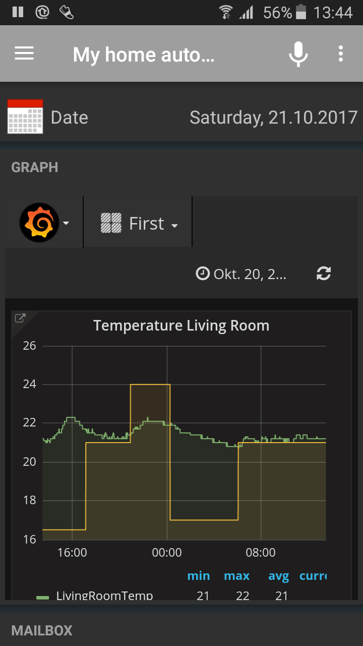

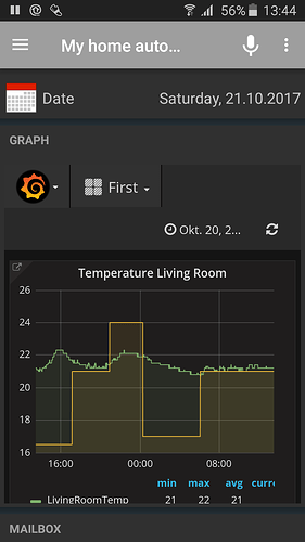

So this made gafana work also in the AndroidApp
Frame{ Webview height=10
       url="http://<IP_HOST>:3000/dashboard-solo/db/<PANELNAME>?panelId=<PANELID>& <...>

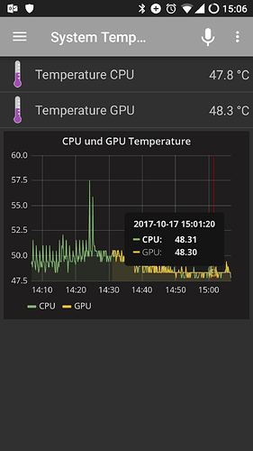

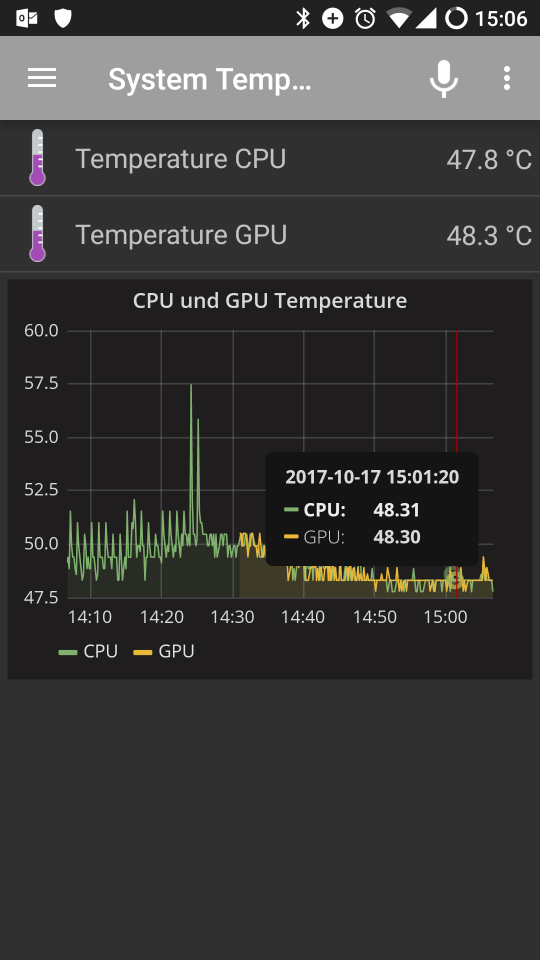

This is the sitemap view in the browser.
This is the sitemap view in the App.
Thank you @ThomDietrich for the nice tutorial. Maybe this was allready known, but i could not find anything about it.

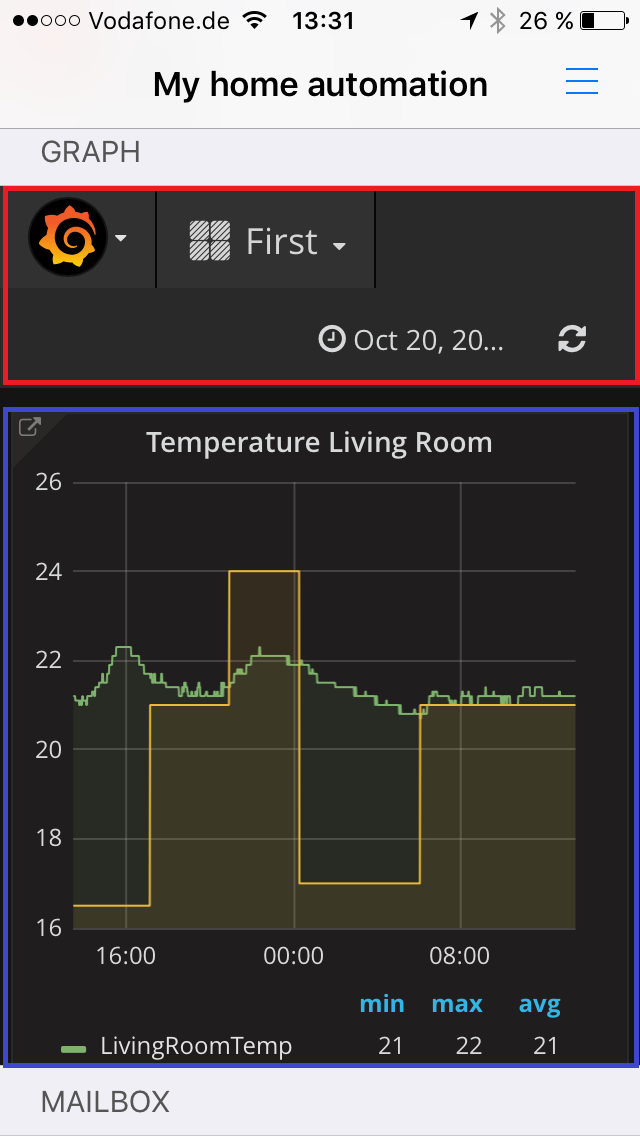

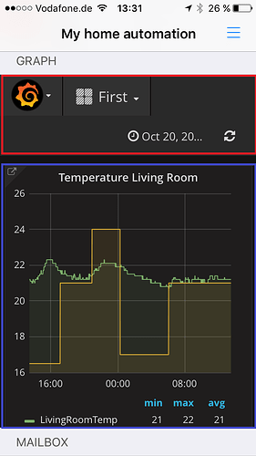

i followed your instructions and i get the graph displayed in the app but with the options menu from above that enables you to chose the time range and the dashboard (marked with a red frame in the picture) . this is how i declared my webwiew element :
Webview  height=10 url="http://user:password@192.168.0.45:3000/dashboard/db/first?refresh=5s&panelId=3&fullscreen&edit&orgId=1&tab=general&from=1508498834960&to=1508585234960"
This is displaying the following both in android and ios apps :
Do you have any idea how get rid of the section marked with red and keep only the plot (marked with purple)?
Thanks in advance.
ps : that section i want away si being displayed also in the browser.
the the picture from the android app.
@Adi_Vacaru have a closer look to my link, use dashboard-solo and not dashboard.
that does it. thanks a lot.

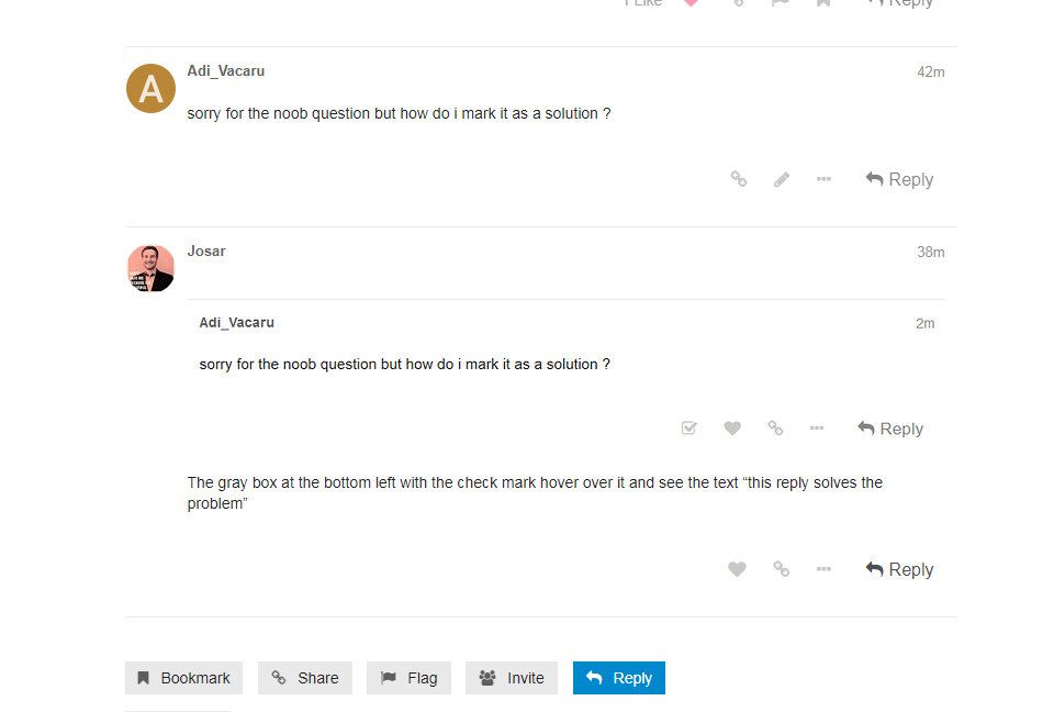

sorry for the noob question but how do i mark it as a solution ?
The gray box at the bottom left with the check mark hover over it and see the text “this reply solves the problem”
i don’t have that one :
