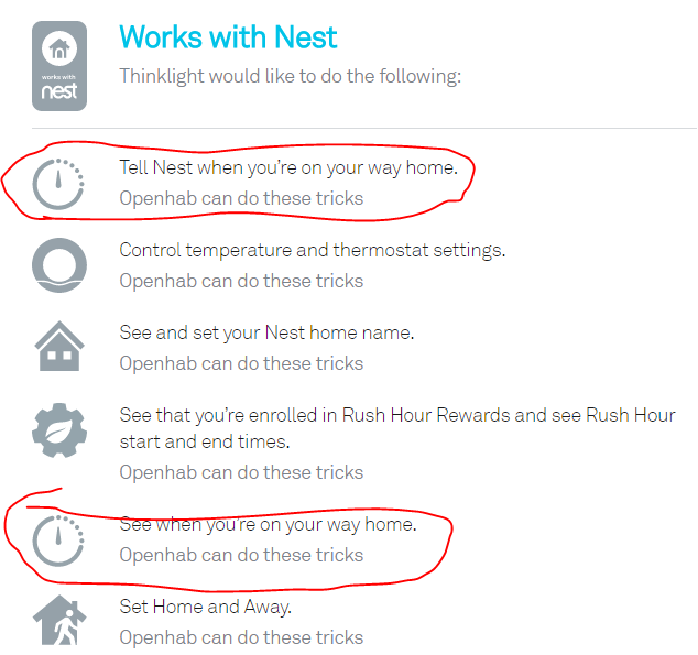

  3. In developers Authorization URL when I accept permissions there is a feature, for Nest Thermostat to know when you are at home, can this be implemented to show up in binding?

Not possible with the current API as far as I know. You could also check the values of the temperature and set_point channels. When they differ you would know that Nest is heating (or cooling). I think this is also the logic used by Nest to show an orange or blue color in their App when there is heating/cooling going on.
You can already read this information using the eta_begin channel on a Structure thing. The binding could be improved to also allow for updating it.
That looks like a bug indeed!
