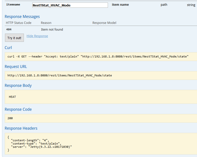

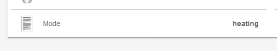

I have some weird behavior going on with this binding. I was using the old binding which would give you a mode of “heat” or “cool” etc.
This new binding seemingly does the same thing, but when I try to display the mode in the basic ui i get “heating” rather than “heat”
REST shows that it’s “HEAT” and the log shows it as “HEAT” as well, but in the UI its “heating”
Text item=NestTStat_HVAC_Mode
any ideas why this might be?

i beg to differ:
String NestTStat_HVAC_Mode “Mode [%s]” { channel=“nest:thermostat:2965c7dd:KeD484GZZTFkb3eBbV4EzVBPx9yKQrvJ:mode” }
Hmm, guess I don’t know then. The wiki here:
https://docs.openhab.org/addons/bindings/nest/readme.html
Shows “state” reporting “heating”, “cooling”, etc and mode reporting
“HEAT”, “COOL” etc.

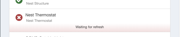

I’ve just switched over, updated my things and items. The cameras and protects are working fine, but the thermostat is not working. Throws the following error every few seconds
2018-02-08 16:36:57.382 [DEBUG] [g.nest.handler.NestThermostatHandler] - Updating thermostat DEVICEID_HERE
2018-02-08 16:36:57.416 [WARN ] [nternal.rest.NestStreamingRestClient] - An exception occurred while processing the inbound event
	at org.openhab.binding.nest.handler.NestThermostatHandler.getChannelState(NestThermostatHandler.java:56) ~[?:?]
	at org.openhab.binding.nest.handler.NestThermostatHandler.getChannelState(NestThermostatHandler.java:1) ~[?:?]
	at org.openhab.binding.nest.handler.NestBaseHandler.lambda$0(NestBaseHandler.java:135) ~[?:?]
	at java.util.ArrayList.forEach(ArrayList.java:1257) ~[?:?]
	at java.util.Collections$UnmodifiableCollection.forEach(Collections.java:1080) ~[?:?]
	at org.openhab.binding.nest.handler.NestBaseHandler.updateChannels(NestBaseHandler.java:135) ~[?:?]
	at org.openhab.binding.nest.handler.NestThermostatHandler.onNewNestThermostatData(NestThermostatHandler.java:160) ~[?:?]
	at java.lang.Iterable.forEach(Iterable.java:75) ~[?:?]
	at org.openhab.binding.nest.handler.NestBridgeHandler.broadcastDevices(NestBridgeHandler.java:213) ~[?:?]
	at org.openhab.binding.nest.handler.NestBridgeHandler.lambda$1(NestBridgeHandler.java:208) ~[?:?]
	at java.util.concurrent.CopyOnWriteArrayList.forEach(CopyOnWriteArrayList.java:891) ~[?:?]
	at org.openhab.binding.nest.handler.NestBridgeHandler.broadcastDevices(NestBridgeHandler.java:208) ~[?:?]
	at org.openhab.binding.nest.handler.NestBridgeHandler.onNewTopLevelData(NestBridgeHandler.java:388) ~[?:?]
	at org.openhab.binding.nest.internal.rest.NestStreamingRestClient.lambda$4(NestStreamingRestClient.java:206) ~[?:?]
	at org.openhab.binding.nest.internal.rest.NestStreamingRestClient.onEvent(NestStreamingRestClient.java:206) ~[?:?]
	at org.glassfish.jersey.media.sse.EventSource$EventProcessor.notify(EventSource.java:687) [180:org.glassfish.jersey.media.jersey-media-sse:2.22.2]
	at org.glassfish.jersey.media.sse.EventSource$EventProcessor.notify(EventSource.java:681) [180:org.glassfish.jersey.media.jersey-media-sse:2.22.2]
	at org.glassfish.jersey.media.sse.EventSource$EventProcessor.onEvent(EventSource.java:668) [180:org.glassfish.jersey.media.jersey-media-sse:2.22.2]
	at org.glassfish.jersey.media.sse.EventSource$EventProcessor.run(EventSource.java:614) [180:org.glassfish.jersey.media.jersey-media-sse:2.22.2]
	at java.util.concurrent.ScheduledThreadPoolExecutor$ScheduledFutureTask.access$201(ScheduledThreadPoolExecutor.java:180) [?:?]
	at java.util.concurrent.ScheduledThreadPoolExecutor$ScheduledFutureTask.run(ScheduledThreadPoolExecutor.java:293) [?:?]
It’s also marked as “waiting to refresh”:
The binding does appear to be getting all of the information from nest:
2018-02-08 16:44:33.440 [DEBUG] [nternal.rest.NestStreamingRestClient] - Received ‘put’ event, data: {“path”:“/”,“data”:{“devices”:{“thermostats”:{“DEVICEID_HERE”:{“humidity”:25,“locale”:“en-US”,“temperature_scale”:“F”,“is_using_emergency_heat”:false,“has_fan”:true,“software_version”:“5.6.6-4”,“has_leaf”:false,“where_id”:“WHEREID_HERE”,“device_id”:“DEVICEID_HERE”,“name”:“Thermostat”,“can_heat”:true,“can_cool”:true,“target_temperature_c”:20.5,“target_temperature_f”:69,“target_temperature_high_c”:24.0,“target_temperature_high_f”:75,“target_temperature_low_c”:20.0,“target_temperature_low_f”:68,“ambient_temperature_c”:20.0,“ambient_temperature_f”:68,“away_temperature_high_c”:24.0,“away_temperature_high_f”:76,“away_temperature_low_c”:12.5,“away_temperature_low_f”:55,“structure_id”:“STRUCTUREID_HERE”,“fan_timer_active”:true,“fan_timer_timeout”:“1970-01-01T00:00:00.000Z”,“hvac_mode”:“heat”,“name_long”:“Thermostat Thermostat”,“is_online”:true,“last_connection”:“2018-02-08T21:34:36.468Z”,“hvac_state”:“heating”}},“smoke_co_alarms”:
etc
It looks like the fan_timer_duration property is missing which causes the exception @omatzyo . You can probably fix this by making sure the “Thermostat read/write v6” permission is enabled in the Nest Developer console. This property was added in v6. See also the earlier discussion in this thread.
I’ll put in a PR in the future so null values no longer result in such exceptions.
You are absolutely correct. I’m not sure how I missed that. Sorry. Updating to v6 fixed the error. Thank you!
I am seeing the same behavior.
openhab> smarthome:status Nest_hvac_mode
HEAT
Untitled 3
2018-02-09 07:04:15.273 [DEBUG] [nternal.rest.NestStreamingRestClient] - Received ‘put’ event, data: {“path”:“/”,“data”:{“devices”:{“thermostats”:{“”:{“humidity”:20,“locale”:“en-US”,“temperature_scale”:“F”,“is_using_emergency_heat”:false,“has_fan”:true,“software_version”:“5.6.6-4”,“has_leaf”:false,“where_id”:“”,“device_id”:“”,“name”:“Thermostat”,“can_heat”:true,“can_cool”:true,“target_temperature_c”:19.0,“target_temperature_f”:67,“target_temperature_high_c”:24.0,“target_temperature_high_f”:75,“target_temperature_low_c”:20.0,“target_temperature_low_f”:68,“ambient_temperature_c”:19.0,“ambient_temperature_f”:67,“away_temperature_high_c”:24.0,“away_temperature_high_f”:76,“away_temperature_low_c”:12.5,“away_temperature_low_f”:55,“eco_temperature_high_c”:24.0,“eco_temperature_high_f”:76,“eco_temperature_low_c”:12.5,“eco_temperature_low_f”:55,“is_locked”:false,“locked_temp_min_c”:20.0,“locked_temp_min_f”:68,“locked_temp_max_c”:22.0,“locked_temp_max_f”:72,“sunlight_correction_active”:false,“sunlight_correction_enabled”:true,“structure_id”:“”,“fan_timer_active”:false,“fan_timer_timeout”:“1970-01-01T00:00:00.000Z”,“fan_timer_duration”:15,“previous_hvac_mode”:“”,“hvac_mode”:“heat”,“time_to_target”:“~0”,“time_to_target_training”:“ready”,“where_name”:“Thermostat”,“label”:“”,“name_long”:“Thermostat Thermostat”,“is_online”:true,“last_connection”:“2018-02-09T12:00:03.411Z”,“hvac_state”:“heating”}},“smoke_co_alarms”:
etc
So, the binding does have the correct value:
"hvac_mode":"heat"
Here is my item:
String Nest_hvac_mode "HVAC Mode [%s]" (Nest_Therm_ground,changed_restored,Weather) { channel="nest:thermostat:my_home_account:ground_thermostat:mode" }
It also retains the “heating” value when the “hvac_state” updates to “off”.
Is there something that is processing this and changing to all caps? Perhaps its related to the strange behavior we’re noticing?
