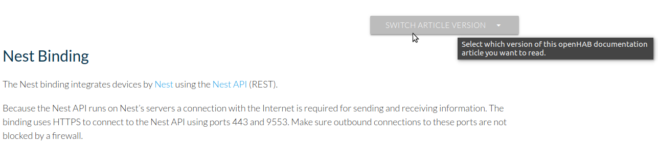

Indeed, I am using the “latest” documentation. I was not aware of this selection early on in my setup travails… and in fact it was my struggles with setting up the Nest binding that turned me on tho the fact that this documentation version selections exists. Early, early in my openHAB deployment (a whole month ago!), I had Googled “openHAB Nest binding” and the link it returned happened to be the OH1 doc link. I did not know the difference and got really frustrated because I could not get the binding to work properly. I even blew away my entire instance and started over with a clean openHABian flashed image! Well, as soon as I found the “latest” doc, bingo, following those instructions got the Nest binding working in no time flat. So, now I realize that in some instances the “latest” is truly that, the latest as associated with a newer SNAPSHOT rather than the “Release”. One more bit of knowledge to tuck away :wink:
I decided to proceed with a test… I renamed the new JAR to match the original JAR… and temperatures are in F. Still missing some of the channels even using the 2.2 doc… but they are not of consequence to what I’m wnating to automate.
That’s good news @meingraham! :slight_smile: The name of the JAR does not really matter.
