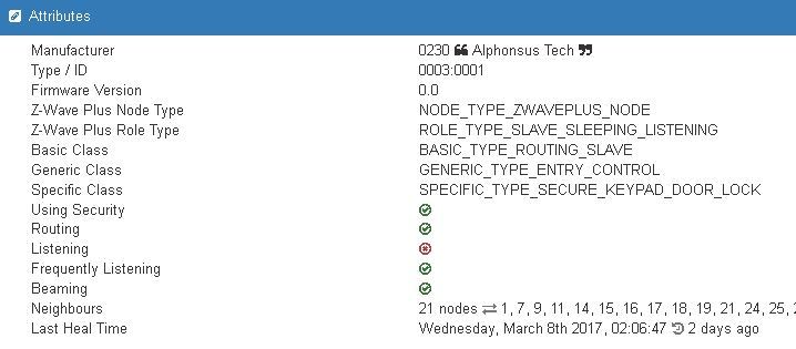

The zwave binding creates the xml-files when the device is initialized, nothing we should do ourselves. The id-lock is already in the device database so you should be good to go. What attributes are listed for idlock in the thing section in Habmin? Mine looks like this:

Maybe it hasn’t initialized properly. Missing xml would suggest this. What does the attribute section for the device say? It should look like the one I posted above. For me it took a little time, but not hours. If still problems and marked as failed it might be worth a try excluding and including again
