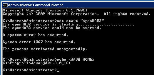

When typing "net start “openHAB2"” , about 20 dots are comming, and the information "system error 1067 has occurred ".
The computer managemet shown openHAB2 as a service, but it also doesn’t start.

Didn’t help:
Do you have any other ideas?
Philipp
I believe 1067 is related to permissions. Make sure the user id under which you run the service has access to any required directories and files and is allowed network access.

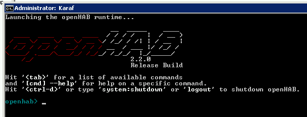

When staring start. bat this happens:
Looks okay, doesn’t it?
Thank you
Philipp
Have you change the C:\openHAB2\userdata\etc\openHAB2-wrapper.conf as described here?
https://docs.openhab.org/installation/windows.html#updating-the-openhab-runtime
Yes, that’s what OpenHab looks like when you start it via the batch file. So we know that the application is running.

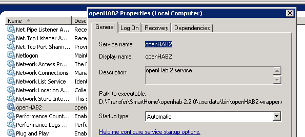

Hello, I think I’ve found my mistake.
I first tried to install from a different folder and this folder is still shown in the Services as “Path to executable”:
It is not possible to install the service again, as it already exists.
How do I delete this service to install it again?
Thanks for your help and sorry for my mistakes
Philipp
Go into the registry. (Start → run… → regedit). Search for “openHAB2” (Service) and then change the path to your executable.

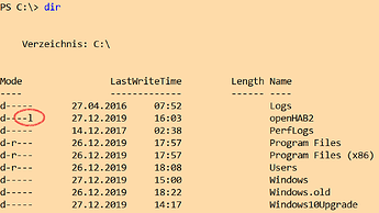

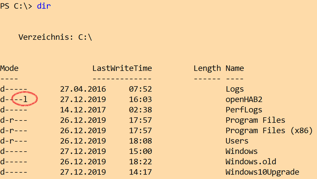

Hi all, I’m also a newbie, so please forgive any stupid questions! I’m facing a very similar situation.
I followed the description from here step by step. When trying to start the service, I got system error 1067.
The installed service points to the path C:\openHAB2\userdata\bin\openHAB2-wrapper.exe -s C:\openHAB2\userdata\etc\openHAB2-wrapper.conf - is this correct? If I try to execute this command manually (from an elevated shell, of course), I get:
PS C:\openHAB2> C:\openHAB2\userdata\bin\openHAB2-wrapper.exe -s C:\openHAB2\userdata\etc\openHAB2-wrapper.conf
Attempting to start openHAB2 as an NT service.
Calling StartServiceCtrlDispatcher...please wait.
StartServiceControlDispatcher failed!
For help, type
C:\openHAB2\userdata\bin\openHAB2-wrapper.exe /?
PS C:\openHAB2> C:\openHAB2\userdata\bin\openHAB2-wrapper.exe /?
FATAL  | wrapper  | Unable to open configuration file. C:\?
PS C:\openHAB2>
Can you give me any pointer how to solve the problem? Thanks in advance!
Christoph
