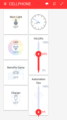

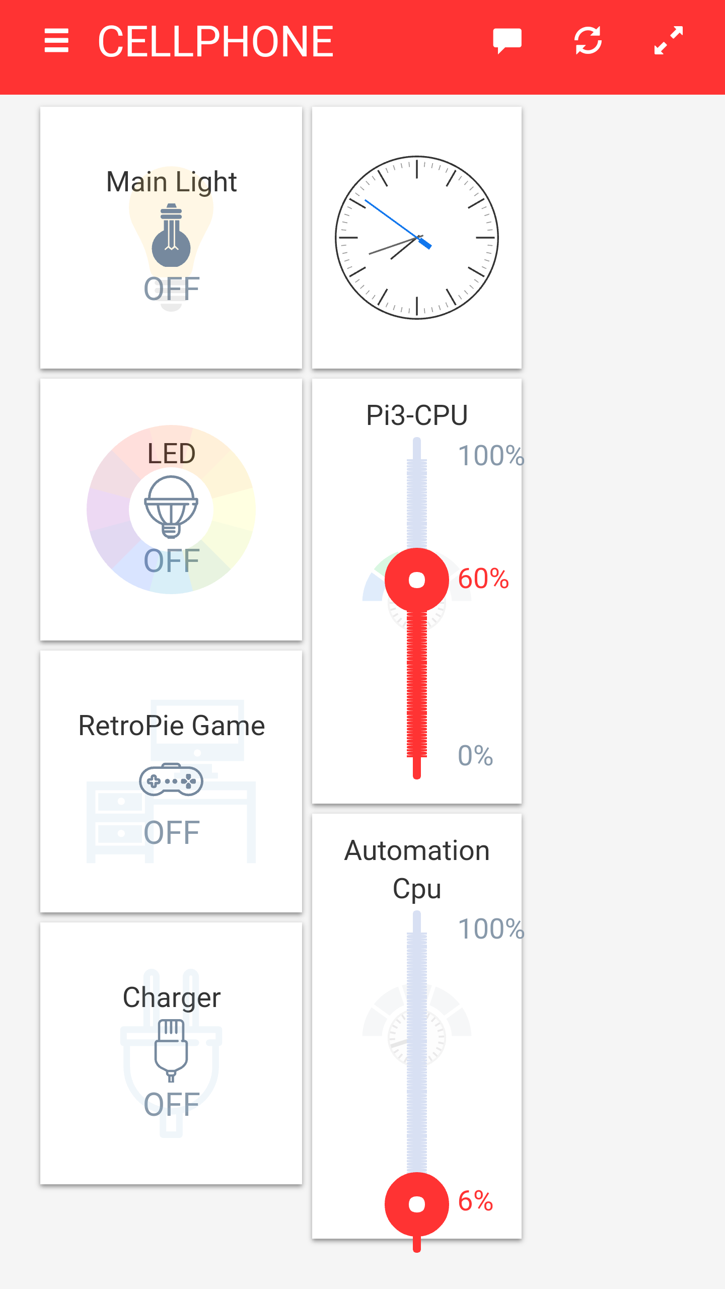

Hi, Where did you get those immages from? how do you do them?
This is Habpenal and this pictures i posted is just from the openhab2 server… From habpenal custimize and edit
