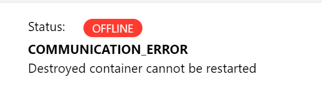

But when i save this result i get:
Any idea what i am missing with these steps?
Try latest snapshot of the binding.
@J-N-K Hi Jan, that worked!
Thank you for your suggestion!
