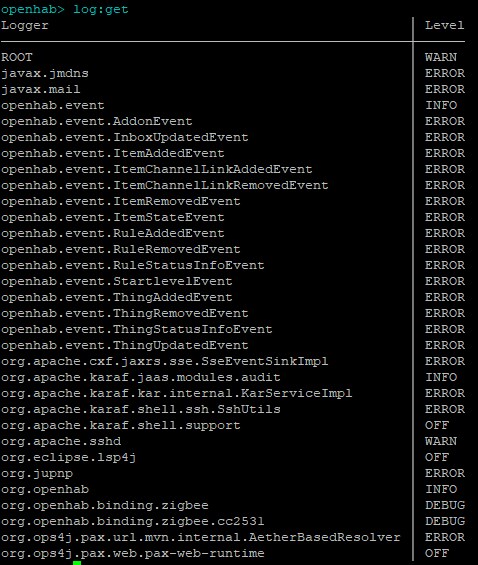

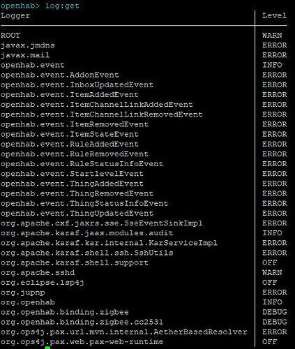

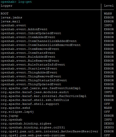

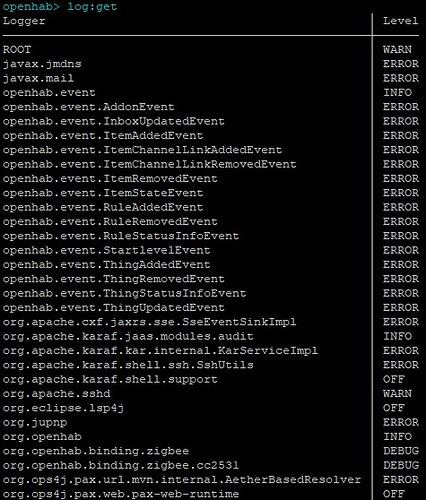

I set up debug logs like this in the console:
openhab> log:set DEBUG org.openhab.binding.zigbee
openhab> log:set DEBUG org.openhab.binding.zigbee.cc2531
Seems to be ok; s. screenshot.
Hopefully I did it right. I will provide a debug log, when the problem comes up again.

I thought this is the log which is needed…sorry.
Screenshot of logs I set up:
EDIT: Found out, that the controllers working, even if they are shown as offline.
