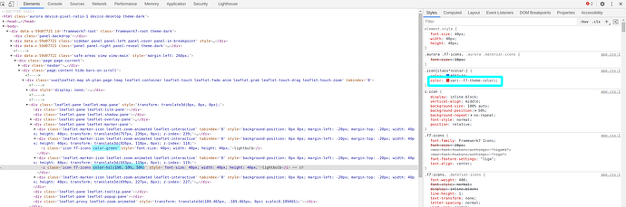

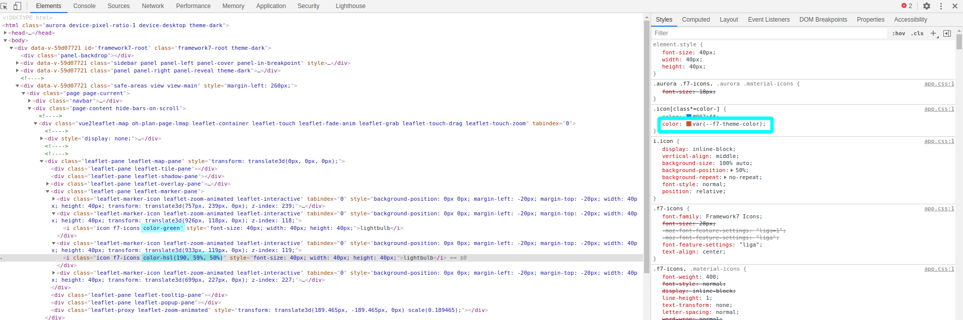

It seems that the value provided for iconColor is transformed to an HTML class which is prefixed with color- and the CSS color property is set to var(--f7-theme-color).
For example
  • the iconColor value green is transformed to HTML class color-green and the used CSS color is indeed green (#4cd964),
  • the iconColor value hsl(190, 59%, 50%) is transformed to HMTL class color-hsl(190, 59%, 50%) but the used CSS color is red (#e64a19).

and various different color values like green, hsl(190, 59%, 50%) and now the result is that the color- CSS class is gone and the icon becomes white.
I may’ve been unclear here - The css only works on the standalone f7-/oh-icon component and not on the oh-plan-marker - there is no way to change the color of this (the marker on the image) component yet (besides the f7-theme-colors I linked above).
As you already found out, the reason for this is the --f7-theme-color css-variable - it gets set by the component itself and will overwrite every color-style which is set via css.
