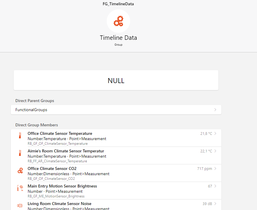

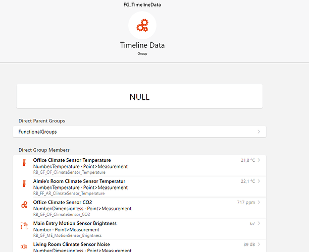

That is no so complicated. Typically you define a group that id referenced in your *.persist file. Than you have to create the goup in the ui.
I use a group called FG_TimeLine. Then you could edit the group and add members to it an all these items are persited.

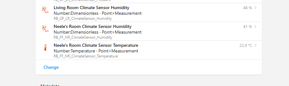

I the ui there is the group. You will find it in items
With the chage Button at the bottom you could add items to the group

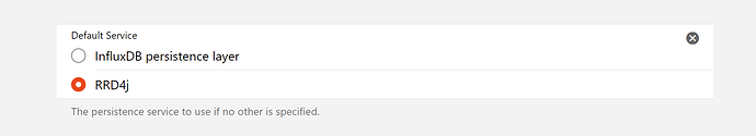

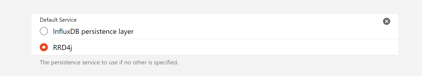

Found Solution:
I needed to configure the system default persistence found in system services under persistence after adding a new persistence provider.
setting back to RRD4 made the charts work again but I suppose any persistence could power the charts. Can anyone confirm?
I can confirm that I have the same experience. Configuring the influx persistence removed the ‘default’ RRDJ4 value.
setting it back to default did the trick
hmn, the strange thing with me is I haven’t configured any items yet,
but some already are in the influx db, like they were created when the default was set to influx, but they keep sending data after setting it back to rrd4j too
Setting the default persistence does not change how the data get saved to the databases. The default is which database gets used when you don’t explicitly tell it which database to use in a query and it’s the database that gets used to generate charts in MainUI. But Items will be saved to all configured databases according to the defined persistence strategies.
