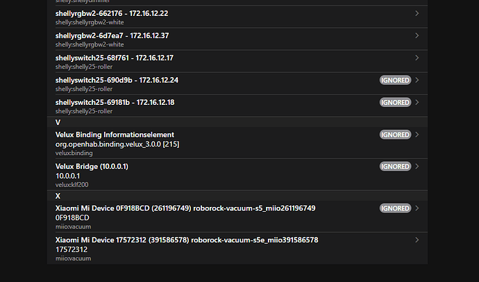

I found that for me also unexpectedly some other items (even from other bindings) show up as ignored instead of the ones I did ignore. Is that also the case for you?
Just want to throw in that it happens here the same way. Randomly ignoring things, but not binding specific. I had all things ignored “except” the shelly yesterday
