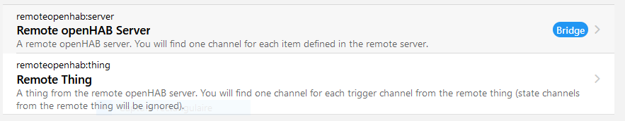

Yes, things have only trigger channels. This is explained in the documentation and even in UI on thing description.
And extract from the binding documentation:
“On the thing thing, you will not find all channels from your remote thing. Only trigger channels from your remote thing will be created. All state channels from your remote thing will be ignored (use the server thing to link a local item to a remote (item).”

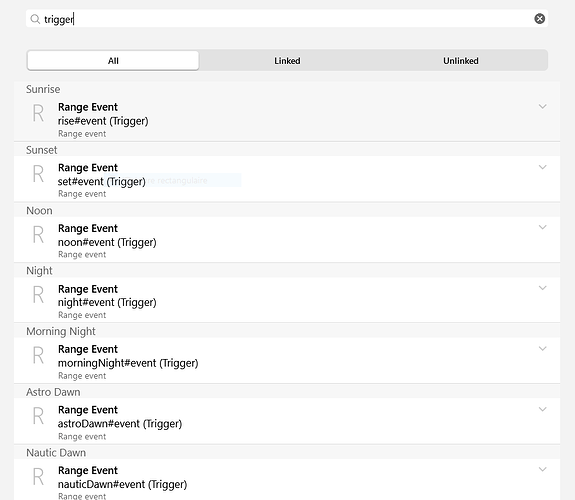

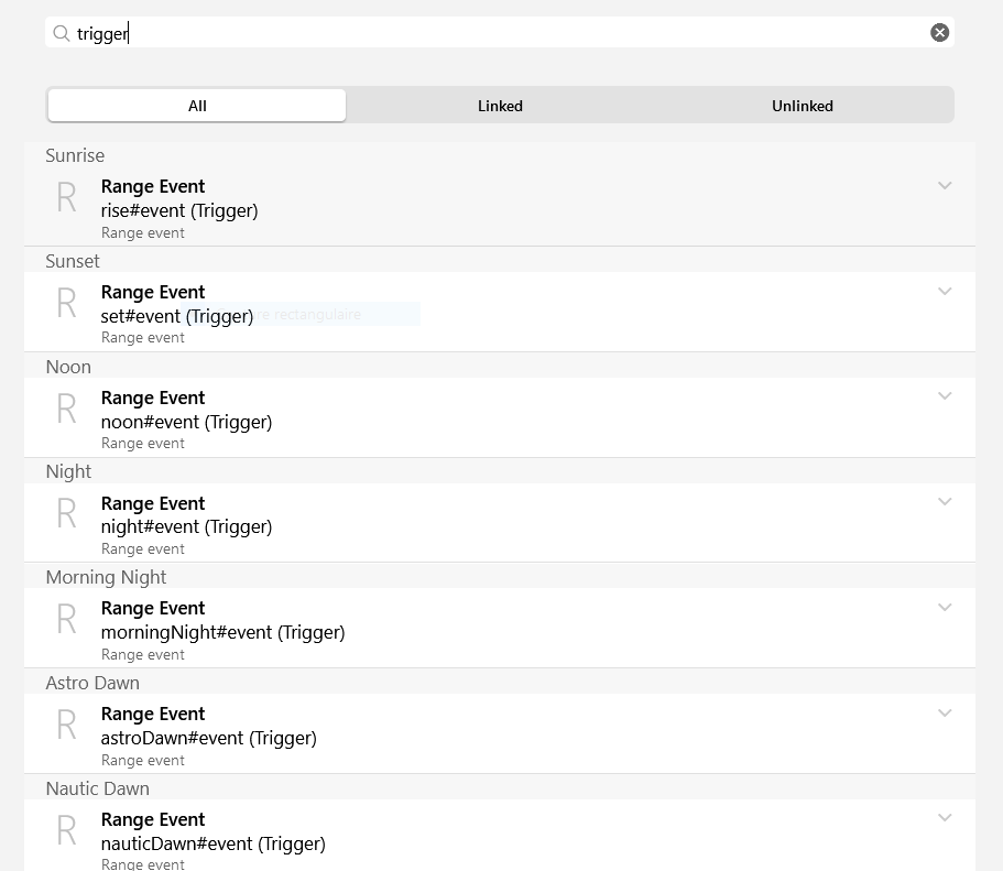

What are some examples of astro trigger channels? I thought when I tried astro I got no channels, but my memory may be mistaken..
I let you check, there are several like nightEvent for example if I correctly remembered.
Ok, I was able to setup a z-wave light item on OpenHAB3 from OpenHAB2 server. I can control the light from the item menu, but when I try to create a rule for for this item it doesn’t appear in the listing of available items in the rule menu. I hope this makes sense.
Just a partial snapshot (there are even more for the Astro thing):
Thanks. Some of those are what i wanted. I will test again then.
