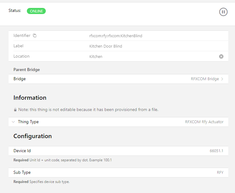

It’s a long time since I set mine up and as far as I recall, there was no problem moving them to OH3 but here is the Thing definition, in case it helps:
Thing rfy KitchenBlind “Kitchen Door Blind” @ “Kitchen” [ deviceId=“66051.1” , subType=“RFY”]
Thing rfy KitchenWindowBlind “Kitchen Window Blind” @ “Kitchen” [ deviceId=“66051.2” , subType=“RFY” ]

So you setup the Bridge as a RFXCOM USB Transceiver Thing referencing serial port, then you create a new thing of type RFXCOM Rfy Actuator, referencing the bridge then in that config you add the channel.
I’m not 100% sure if mine uses URTS II but thats how I do my external Somfy blinds.

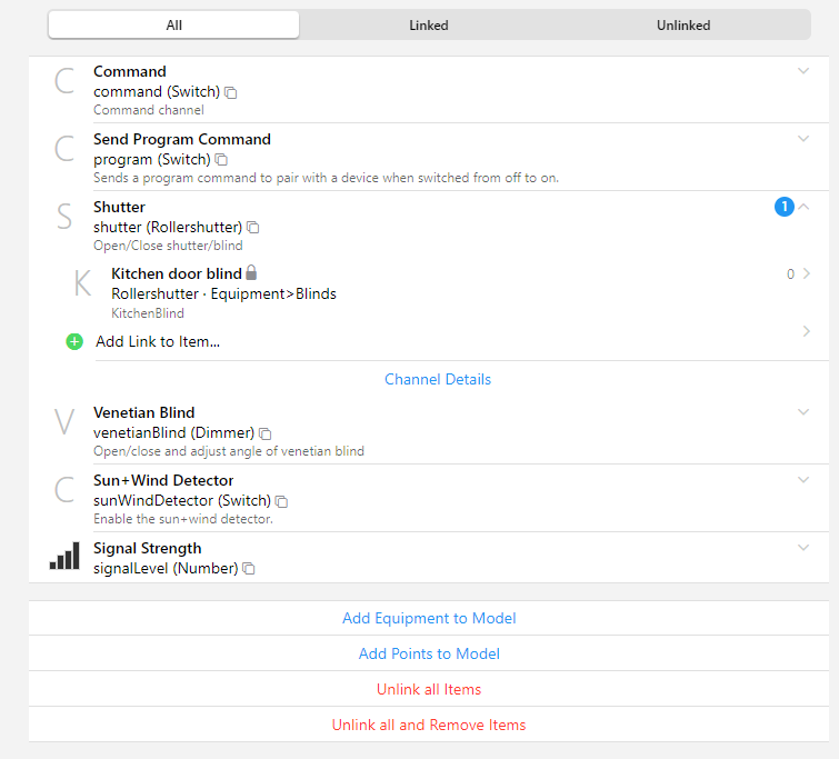

If you create that, it should have a channel called “Shutter”, link that to a RollerShutter type item.
If you put the blind into learning mode and use the item as though it were the remote, the blind should pair with it.

Each Thing needs to be linked to a RollerShutter item. You can do that by selecting the Thing, choose the Channel tab and find the “Shutter” channel, then click on the channel and choose the little green + “Add link to item” icon.
