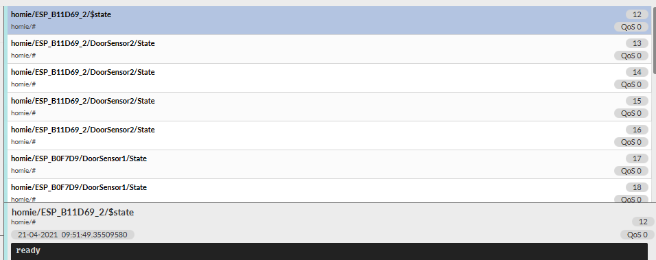

    I’ve updated my ESPEasy devices to use the Homie convention and have confirmed via MQTT.fx they are sending LWT and device updates via MQTT.

According to MQTT.fx the QoS is 0 but the OH log is showing this.
2021-04-21 10:01:16.524 [WARN ] [e.internal.handler.HomieThingHandler] - Homie devices require QoS 1 but Qos 0/2 is configured. Using override. Please check the configuration
I’m not sure what configuration it wants me to check.

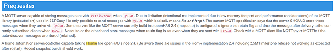

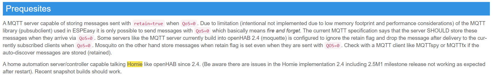

I think the ESPEasy developers believe auto-discover should work in OH3 according to this.
But it does look like it’s still in testing.
https://espeasy.readthedocs.io/en/latest/Controller/C014.html?highlight=homie#setup
The versions talked about there are very old. We are over a year past OH 2.4 and 2.5M1. It says recent snapshots should work which implies that any version since OH 2.5M2 should work as well.
Moquette, the MQTT broker that used to be embedded in OH 2 is no longer supported in OH 3. So you are most likely using Mosquitto which should behave correctly when it receives the QOS=0 but retained=true message.
To check: do you have the JSONPATH and JINJA Transformation Services installed in your openHAB? I think you need them for auto discovery.
I didn’t have JINJA transformation installed but I have installed it now and even clicking scan doesn’t find my devices. But I do see the state being published by the device using MQTT.fx
I also see the LWT was published also and showing ready.

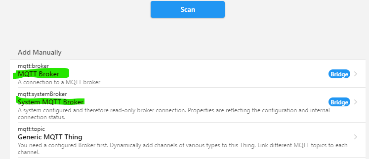

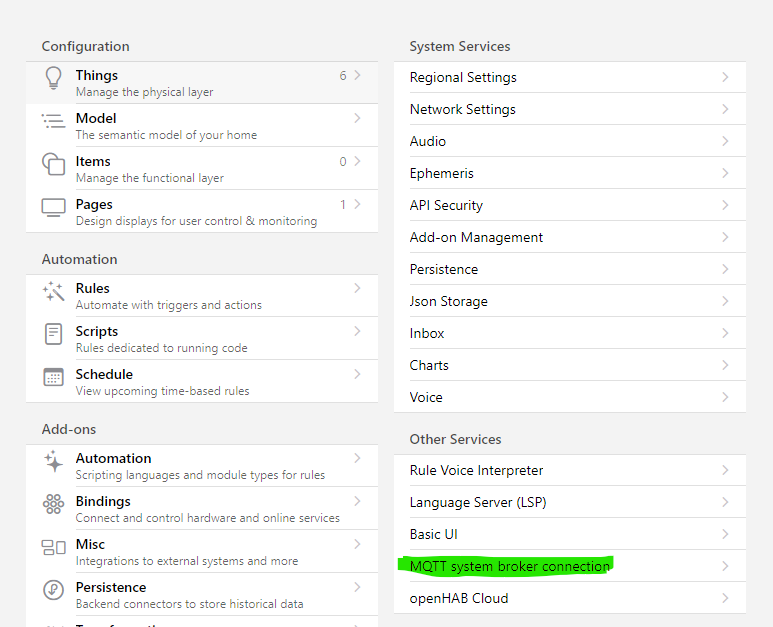

What is the difference in creating a MQTT system broker via the settings page seen here.
VS Manually adding a thing that is a Broker
Should I be using System Broker for the locally installed Mosquitto server?
I attempted to disable the broker I created under things and create a system broker with the same settings but it’s trying to use Port 8883 even if I set the port to 1883.
No, definitely not. Only use a Thing Broker as shown in the tutorials.
