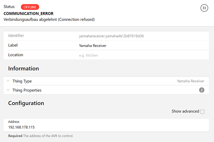

Since 3 days i want to connect to my Yamaha RX-V2700 receiver. But however i want to connect to the bridge the connection refused to it. I am sure i have the right IP-Adress and the answer also to a ping.
Has anybody an idea which mistake i did?

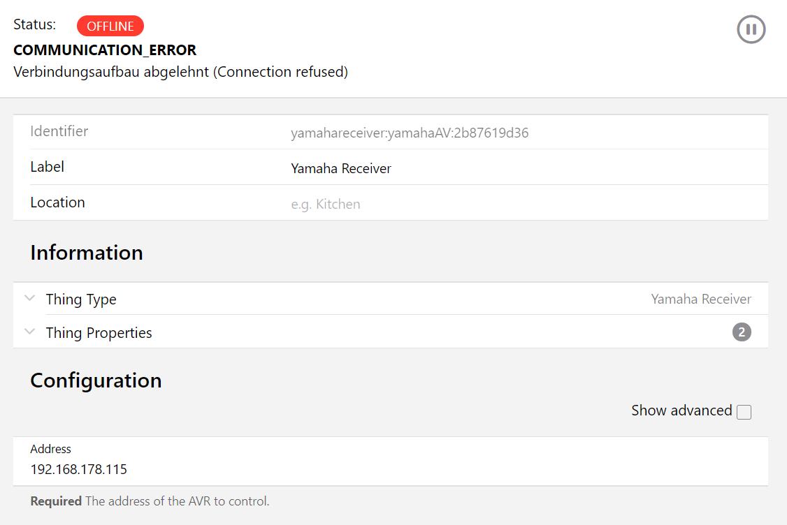

if i want directly contact in the UI to the Bridge i get the following:
and if i do it with a things-file with the following lines i got the same answer:
Bridge yamahareceiver:yamahaAV:ReceiverID “Yamaha Receiver Bridge Name” [host=“192.168.178.115”, refreshInterval=20] {

18:11:28.950 [INFO ] [del.core.internal.ModelRepositoryImpl] - Loading model ‘Yamaha.things’
18:13:32.561 [INFO ] [hab.event.ThingStatusInfoChangedEvent] - Thing ‘yamahareceiver:yamahaAV:7bb658631c’ changed from UNINITIALIZED to INITIALIZING
18:13:32.589 [INFO ] [hab.event.ThingStatusInfoChangedEvent] - Thing ‘yamahareceiver:yamahaAV:7bb658631c’ changed from INITIALIZING to OFFLINE (CONFIGURATION_PENDING): W aiting for connection with Yamaha device
18:13:35.750 [WARN ] [.internal.handler.YamahaBridgeHandler] - Communication error. Please review your Yamaha thing configuration.
18:13:35.759 [INFO ] [hab.event.ThingStatusInfoChangedEvent] - Thing ‘yamahareceiver:yamahaAV:7bb658631c’ changed from OFFLINE (CONFIGURATION_PENDING): Waiting for conne ction with Yamaha device to OFFLINE (COMMUNICATION_ERROR): Keine Route zum Zielrechner (Host unreachable)
18:13:55.186 [INFO ] [hab.event.ThingStatusInfoChangedEvent] - Thing ‘yamahareceiver:yamahaAV:7bb658631c’ changed from OFFLINE (COMMUNICATION_ERROR): Keine Route zum Zie lrechner (Host unreachable) to REMOVING
18:13:55.205 [INFO ] [hab.event.ThingStatusInfoChangedEvent] - Thing ‘yamahareceiver:yamahaAV:7bb658631c’ changed from REMOVING to REMOVED
18:13:55.217 [INFO ] [hab.event.ThingStatusInfoChangedEvent] - Thing ‘yamahareceiver:yamahaAV:7bb658631c’ changed from REMOVED to UNINITIALIZED
18:13:55.255 [INFO ] [hab.event.ThingStatusInfoChangedEvent] - Thing ‘yamahareceiver:yamahaAV:7bb658631c’ changed from UNINITIALIZED to UNINITIALIZED (HANDLER_MISSING_ER ROR)
18:28:11.343 [INFO ] [hab.event.ThingStatusInfoChangedEvent] - Thing ‘lgwebos:WebOSTV:8bb53143-6657-f5b3-da5b-3dfc9d5ec3e6’ changed from ONLINE: Connected to OFFLINE (CO MMUNICATION_ERROR): Connection Failed:
18:28:11.356 [INFO ] [hab.event.ThingStatusInfoChangedEvent] - Thing ‘lgwebos:WebOSTV:8bb53143-6657-f5b3-da5b-3dfc9d5ec3e6’ changed from OFFLINE (COMMUNICATION_ERROR): C onnection Failed: to OFFLINE: TV is off
18:28:11.373 [INFO ] [openhab.event.ItemStateChangedEvent ] - Item ‘LG_TV0_Power’ changed from ON to OFF
18:28:34.307 [INFO ] [hab.event.ThingStatusInfoChangedEvent] - Thing ‘yamahareceiver:yamahaAV:ReceiverID’ changed from OFFLINE (COMMUNICATION_ERROR): Keine Route zum Zie lrechner (Host unreachable) to OFFLINE (COMMUNICATION_ERROR): Verbindungsaufbau abgelehnt (Connection refused)

18:32:45.549 [INFO ] [hab.event.ThingStatusInfoChangedEvent] - Thing ‘yamahareceiver:yamahaAV:2b87619d36’ changed from UNINITIALIZED to INITIALIZING
18:32:45.573 [WARN ] [.internal.handler.YamahaBridgeHandler] - Communication error. Please review your Yamaha thing configuration.
18:32:45.572 [INFO ] [hab.event.ThingStatusInfoChangedEvent] - Thing ‘yamahareceiver:yamahaAV:2b87619d36’ changed from INITIALIZING to OFFLINE (CONFIGURATION_PENDING): W aiting for connection with Yamaha device
18:32:45.594 [INFO ] [hab.event.ThingStatusInfoChangedEvent] - Thing ‘yamahareceiver:yamahaAV:2b87619d36’ changed from OFFLINE (CONFIGURATION_PENDING): Waiting for conne ction with Yamaha device to OFFLINE (COMMUNICATION_ERROR): Verbindungsaufbau abgelehnt (Connection refused)
