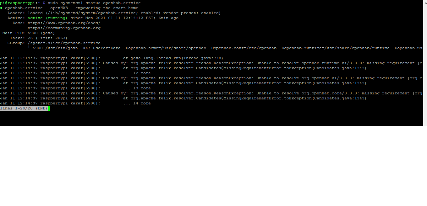

i followed everything from the offical page of openhab
installed zulu and no fix, than installed java 11 and no fix
im having issue installing openhab3 , i tried to upgrade from oh2 to oh3 but same problem, i tried fresh install of oh3 on fresh install raspbain os and same problem..
here :Untitled
Although you stated that java 11 is installed could you please check if the right java version is installed:
java -version
That is java 8. For OH3 java 11 is required.
I made a mistake thought i installed java11, i removed java8 than installed fresh java11 and its working now..
