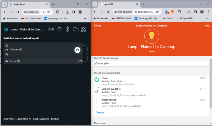

I activated the debugging for the shelly binding. I think the channel receives the update, but the state is not parsed into the item?
situation. openhab items are aligned with shelly states in UI:
I then flip the physical switch, (which is setup in Edge mode):
2023-11-14 14:25:41.930 [DEBUG] [g.shelly.internal.api2.Shelly2ApiRpc] - shellyplus1-441793944e7c: NotifyStatus update received: {"src":"shellyplus1-441793944e7c","dst":"shellyplus1-441793944e7c","method":"NotifyStatus","params":{"ts":1.69996834189E9,"input:0":{"id":0,"state":true}}}
2023-11-14 14:25:41.933 [DEBUG] [y.internal.handler.ShellyBaseHandler] - shellyplus1-441793944e7c: Channel relay#input updated with ON (type class org.openhab.core.library.types.OnOffType).
2023-11-14 14:25:41.974 [DEBUG] [g.shelly.internal.api2.Shelly2ApiRpc] - shellyplus1-441793944e7c: NotifyStatus update received: {"src":"shellyplus1-441793944e7c","dst":"shellyplus1-441793944e7c","method":"NotifyStatus","params":{"ts":1.69996834189E9,"switch:0":{"id":0,"source":"switch","output":false}}}
2023-11-14 14:25:41.976 [DEBUG] [y.internal.handler.ShellyBaseHandler] - shellyplus1-441793944e7c: Channel relay#output updated with OFF (type class org.openhab.core.library.types.OnOffType).
the input item is updated by the channel, but the the output item is not
