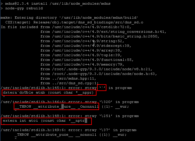

playing with permissions I managed to start installation als openhabian with the following result:
dns_sd_bindings.target.mk:149: recipe for target 'Release/obj.target/dns_sd_bindings/src/dns_sd.o' failed
make: *** [Release/obj.target/dns_sd_bindings/src/dns_sd.o] Error 1
make: Leaving directory '/usr/lib/node_modules/node-red-contrib-homekit/node_modules/mdns/build'
gyp ERR! build error
gyp ERR! stack Error: `make` failed with exit code: 2
gyp ERR! stack     at ChildProcess.onExit (/usr/lib/node_modules/npm/node_modules/node-gyp/lib/build.js:258:23)
gyp ERR! stack     at emitTwo (events.js:106:13)
gyp ERR! stack     at ChildProcess.emit (events.js:194:7)
gyp ERR! stack     at Process.ChildProcess._handle.onexit (internal/child_process.js:215:12)
gyp ERR! System Linux 4.9.35-v7+
gyp ERR! command "/usr/bin/nodejs" "/usr/lib/node_modules/npm/node_modules/node-gyp/bin/node-gyp.js" "rebuild"
gyp ERR! cwd /usr/lib/node_modules/node-red-contrib-homekit/node_modules/mdns
gyp ERR! node -v v7.10.1
gyp ERR! node-gyp -v v3.6.2
gyp ERR! not ok
npm ERR! code ELIFECYCLE
npm ERR! errno 1
npm ERR! mdns@2.3.4 install: `node-gyp rebuild`
npm ERR! Exit status 1
npm ERR!
npm ERR! Failed at the mdns@2.3.4 install script.
npm ERR! This is probably not a problem with npm. There is likely additional logging output above.
npm ERR! A complete log of this run can be found in:
npm ERR!     /home/openhabian/.npm/_logs/2017-12-29T14_15_23_152Z-debug.log

After updating node.js to 9.3.0 and npm 5.6.0, still the same behaviour …
Now I still get errors that seem to have an issue with encoding or anything like that.
