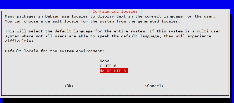

So I went to: 30 System settings → 32 Set system locale
Selected the following line with Space and Enter
[*] de_DE.UTF-8 UTF-8
Then the following message showed up. I pushed Enter
Then i received the following error:

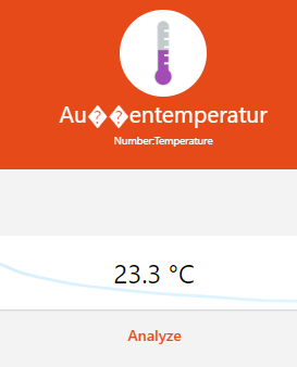

By doing this i am afraid i also destroyed something.
Because now i see the following in the main UI:
I supposed to be 22.6 °C.
Also i dont see German letters like Ä,Ö,Ü anymore :frowning:

After this i do at least have °C again, however still no German letters and no translation to German weekday names:
