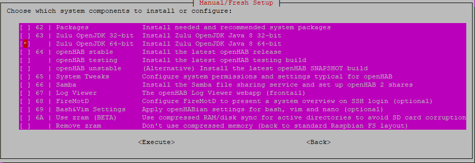

I’ve tried openhabian “Manual/Fresh Setup” and checked " Zulu OpenJDK 64-bit".
However the script installs x32 instead x64. Is this some bug in the script?
