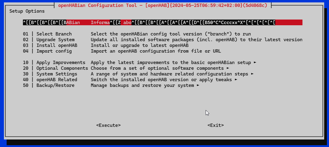

sudo openhabian-config | tee -a output.txt
and
sudo openhabian-config | script output.txt
but with both options, I was not able to operate the config tool because my key inputs were just somehow written onto the dialog box with no functional effect:
So, I just ran the tool using sudo openhabian-config as usual, performed the raw copy (option 54) and copied the text of the power shell box:

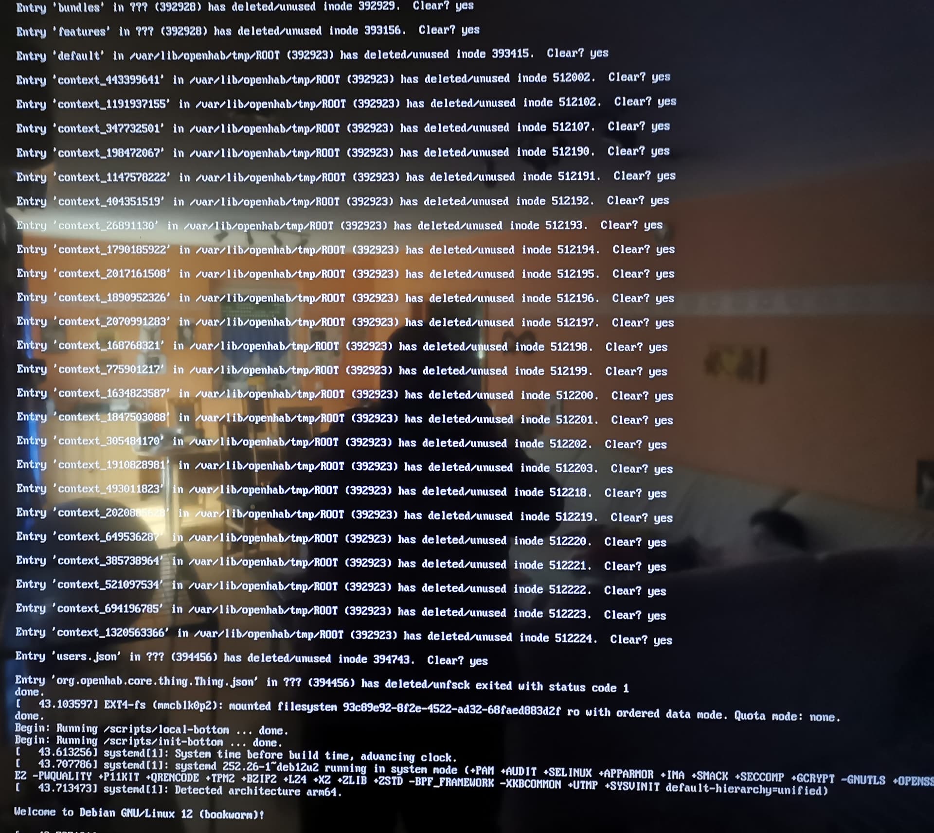

I was only able to take some pictures (in sum, I tried to boot two times):
Can I provide you any further information?

Sorry, currently I do not know how to bring the boot output into a text file. I will check the internet.
I know that screenshots are not good for debugging as you do not see everything and you cannot search for texts. I just thought that they might help you nevertheless. :man_shrugging:
