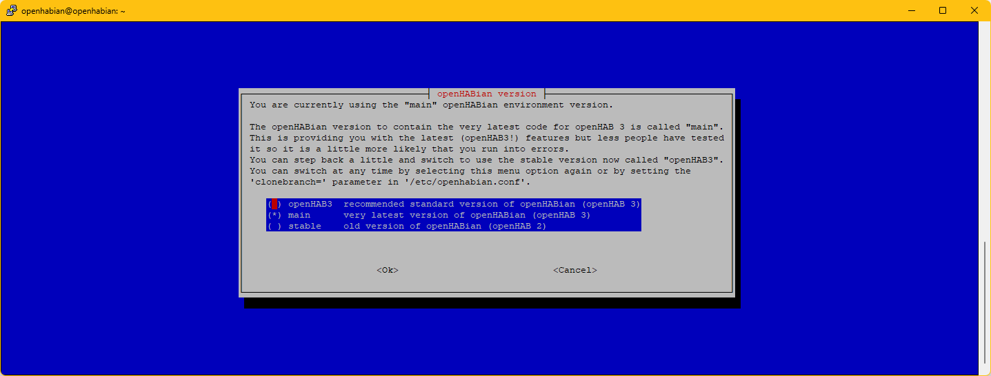

Current/original version of the screen:

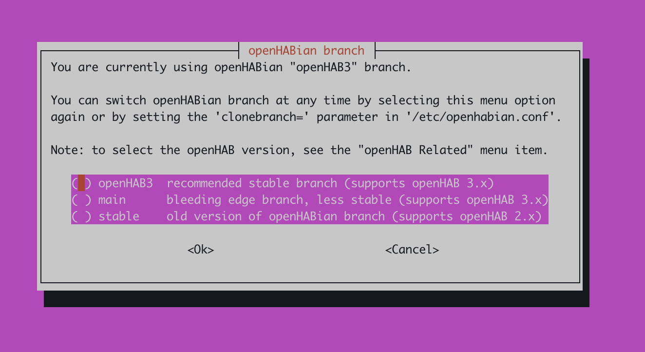

Suggested change:
I’ve also resized the dialog to adjust to the less amount of text.
IMO the branch names themselves could use a rename
stable → stable-2.x
openHAB3 → stable-3.x ← This is probably the #1 source of confusion, amongst many
main → HEAD
But yeah, I understand the headaches involved in changing the branch names around.
In the original screen, saying “to contain the very latest code for openHAB 3” really throws people off. They’d think you’d get the very latest version of openhab - which I’d interpret as 3.4.0-SNAPSHOT

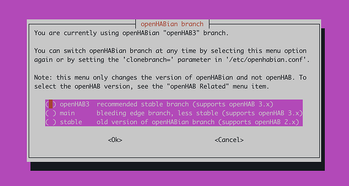

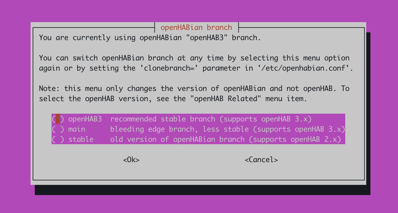

Nevertheless, I’ve updated the screen to this:
Note I can submit these changes as a PR if necessary.

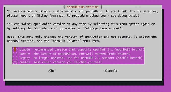

Great feedback! Here’s a revised screenshot:
And this is what it will show when it encountered a custom branch:
I’ve also cleaned up the bash script/code to remove some duplications.

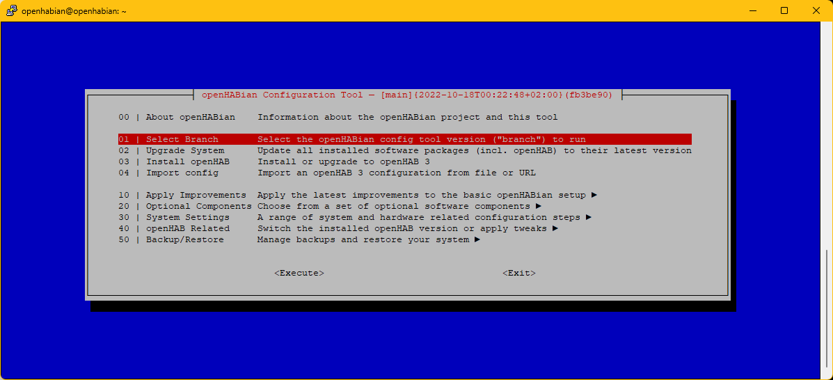

You actually didn’t mention how you ended up in this menu and that’s important, too.
If you choose a menu option like say 42 you are setting the context yourself and I’d expect you to remember that for at least some minutes…
Don’t get me wrong I don’t mind changing the menu wording but it may not be needed at all.
Yes please, thanks. Mind that so far label=branch, but now with abstracted labels you need to introduce a mapping to the proper branch name in the code.
Yes, that’s already in my code. Are you happy with the proposed screenshot?
This is a fair point as well. See the main menu below:
