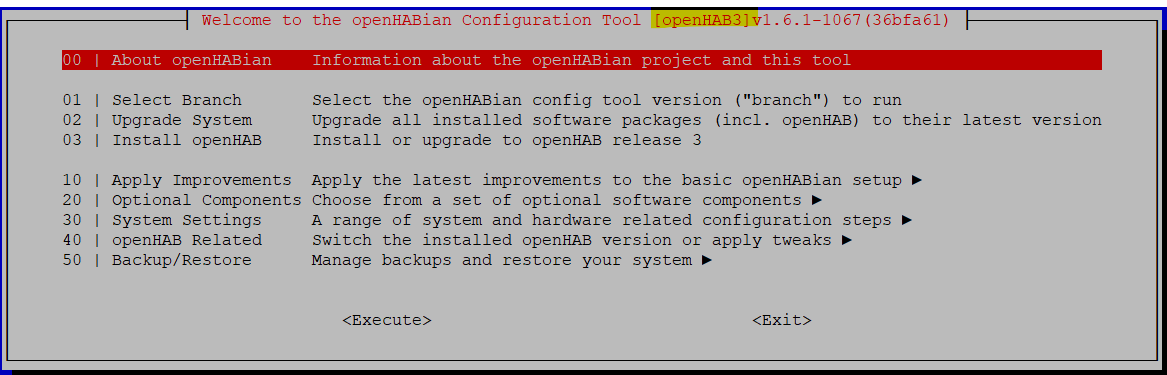

It is not clear for me which menu items on the OpenHABian configuration menu are for OH2 only and which one can still be used after the upgrade to OH3

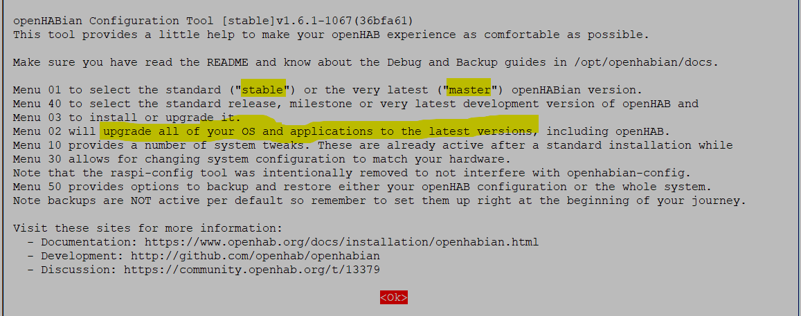

A few days after I upgraded to OH3 I run menu item 02 or 10 because I thought that this is also for OH3 and not only for OH2. As a result Java Zulu8 was installed again and my sitemap was no longer displayed. Reinstalling Java Zulu11 fixed the created problem.
Does “Openhab” mean “Openhab2” in the menu items? Are the phrases “stable” and “master” only related to OH2?
To avoid problems for other users it might be helpful to make it more clear which menu item is for OH2 only or for OH3 only or for both. The menu item for Backup works for OH3 and worked for OH2 before the upgrade.

Thank you @lampy for your reply and “warning”. I’m on OH3 … the above screenshots have been made after I used menu item 2 or 10 which accidently switched the branch of the system back stable (OH2).

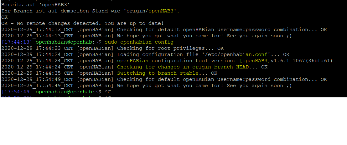

The SSH window shows that I already was on OH3
At 17:44:13 I started openhabian-config, and 17:44:24 the OH3 config menu was displayed and 17:44:35 the system switched to branch stable … I don’t know which … in the menu item “Select branch” I always selected “Openhab3”. Possibly other menu items switch to branch stable (02 or 10 or?) which is not transparent to me.

You possibly have clonebranch= set so any start of openhabian-config will reset your branch.

The menus have titles and/or descriptions that explicitly quote the version (such as “03 - Install or upgrade to openHAB release 3” or the 42 menus).
If they don’t mention the version (such as menus 41) it’s simple: it applies to your currently installed version. BTW menu 41 has been like that for ages, long before OH3 emerged.
No frankly I don’t think it can be made any simpler or clearer than that.
However, you and everybody else are invited to propose any wording that you think is “clearer”.

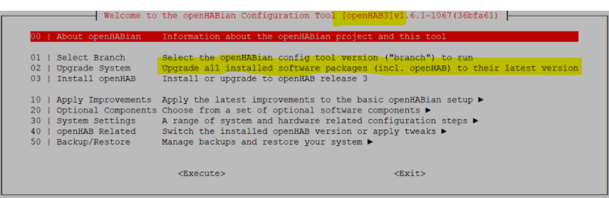

@mstormi According your explanation menu item 02 means that all software packages and OH3 will be upgraded to their latest version when the title of the config menu shows “[openHAB3]”
… and menu item 10 means that I get the latest improvements and bugfixes of OH3 when the title of the config menu shows “[openHAB3]”
No it does not. By ‘title’ I was referring to the column #2 (#1 is the number, #3 is the description)
The window title you refer to shows what openHABian branch you are on.
That does not necessarily mean you have OH3 installed.

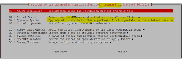

I have upgraded from OH2 to OH3. If I understood correctly so to always have the latest version of OH3 I use openhabian-config and choose Branch = openHAB3 and then menu 2 | “Upgrade System” “Upgrade all installed software packages (incl. OpenHAB) to their latest version”. Is this right?
Not fully because the latest OH code is in the SNAPSHOT branch. If you are on release or testing (menu 41 then 02 will upgrade it to the latest version of the release or testing packages (which is usually older than snapshots).
