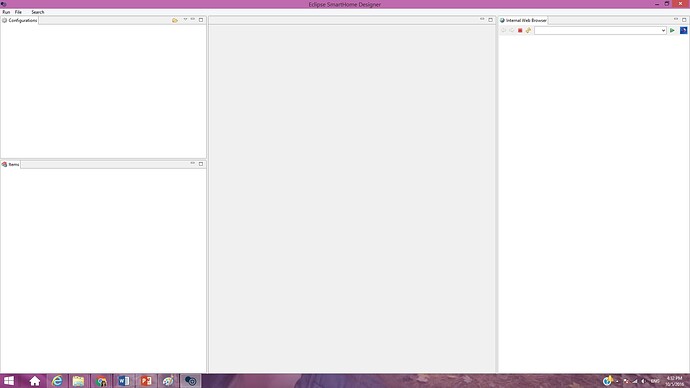

I will later, but really it is blank. Nothing shows up. I have to select the Items folder to see the .items files, Sitemaps folder to see the .sitemap files, ect.
Are you trying to open the network share or a drive the network share is mounted on? I don’t know if the first is even possible but the second is how it should and I do not see why not… :confused:
I’m away from my computer right now but when I select the openHAB-conf folder I should see all the .item, .persist, .sitemap files contained in all the sub folders in the panel in the upper left. At least I did on my OH1 setup. Right now I get nothing. I only see the files if I select their respective folders.

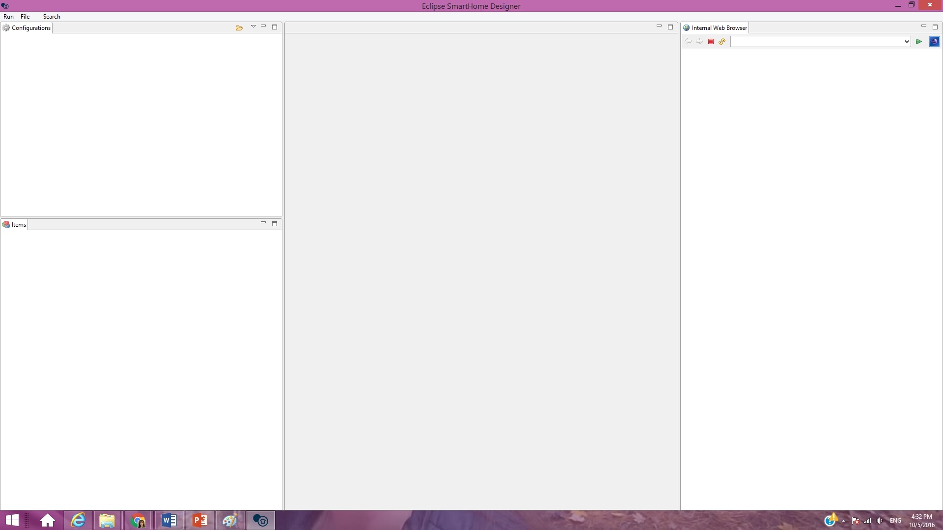

Here you go Thom. As you can see, nothing to see. This is when selecting the OpenHab-conf folder. The same thing happens with OpenHab-userdata folder.
Are you running as an administrator in windows? I couldn’t get the conf folders loaded until doing so.
Just tried doing that… still nothing. :confused:
Because you are talking about folders again… I have to ask again. Did you mount the shares as drives in Windows?
