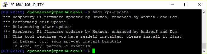

With the latest build of openhabian it is not possible to update to the latest kernel (rpi-update)
Is this a bug, that is already known?
I can confirm this. For rpi-update a package (binutils) needs now to be installed first. However when I did and ran rpi-update, the update bricked my installation (Pi3)…

  1. When I tried to do sudo rpi-update I got the message to do sudo apt-get install binutils:
  2. So I did sudo apt-get install binutils

@3DJupp @syrenius @anfaenger thanks for reporting this issue. This is a major problem we’ll have to deal with quickly.
I’ve taken action and pushed two changes to openHABian.
  1. I’ve improved the serial port function with a few nice features yesterday (not really related to the problem) Fix typo and improve serial port function by SuneRadich · Pull Request #102 · openhab/openhabian · GitHub
  2. I’ve just now removed the suggestion to execute rpi-update and added the command to delete the program from your system with the menu entry “Basic Setup” (or on new installs). Remove rpi-update and suggestion · openhab/openhabian@e14c8d1 · GitHub
This should stop others from running into problems till the issue is solved. Executing rpi-update should not be NEEDED, I’ve just recommended it till now because it’s a good practice. @syrenius your success shouldn’t depend on it.
I’ve opened an issue to investigate the actual problem, till then everyone should refrain from using rpi-update!
