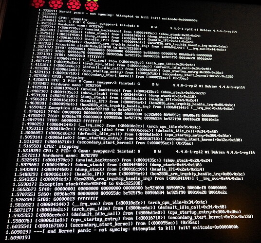

Good day. Today I installed the latest updates via sudo openhabian-config on my RPI3, rebooted, but the openhab was unable to boot. I decided to perform a fresh install. I downloaded the image, wrote it to SD. The installation lasted about an hour. After installation was complete, openhab try to reboot and again nothing
@ThomDietrich I have exactly the same problem.
What to do now and how can I access my config files on the sd card if I have to reinstall everything?
