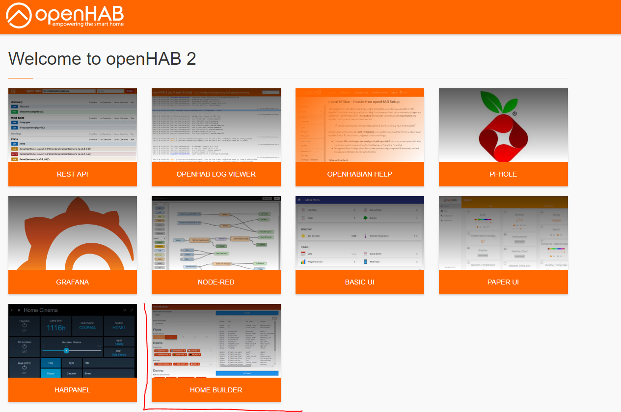

I installed openHAB Generator.
After loging in with SSH I typed openhab-generator. I got the message ā€œcommand not foundā€ even after rebooting.
Do you have any clue why?
Yes. Thats a known issue.
But the generator command was replaced anyway by the homebuilder.

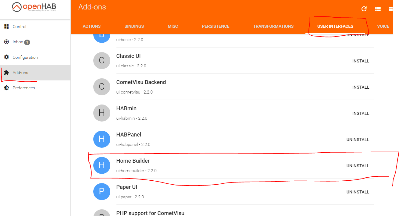

It should be visible on the openhabianpi:8080 web interface when you selected the ā€œstandard packageā€.
When you can’t see Home Builder, you can install it with Paper UI and use it afterwards.
