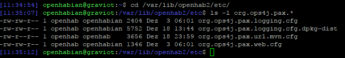

Hi Udo, thanks for your fast reply. yes i come from openhab 2.1. i updatet via apt-get but i have no org.ops4j.pax.logging.cfg.dpkg-new file. see the screeni. have you a another idea?
thanks!
xml - graviotRPI
Just exchange “new” in @Udo_Hartmann example to “dist”. It’s the file of the distribution.
oops, typo… sorry :slight_smile: I meant -dist
thanks all - problem is fixed!
