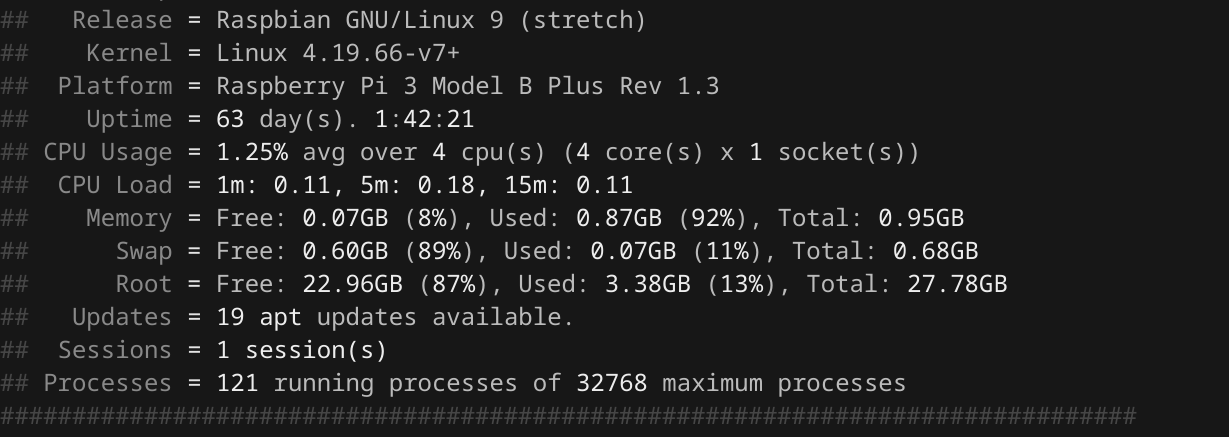

Just thought I’d let folks know that since upgrading to the 2.5.0.M3 milestone, (see my original post above on Sep 21st), OpenHab has been rock solid and the NGRE rules have run flawlessly. My Z-wave device rules have fired consistently without ANY issue over that time-frame.
Also no issues with ssh access or my Pi locking up which happened regularly every 3-4 weeks under the previous OpenHab version/installation.
So… the issue had nothing to do with running my OpenHab from a micro SD card.
Based on this experience, I think I will download the runtime and do the manual-installation from now on.
Here’s a screenshot of my Pi SSH session. You can see the Uptime of 63 days as evidence.
