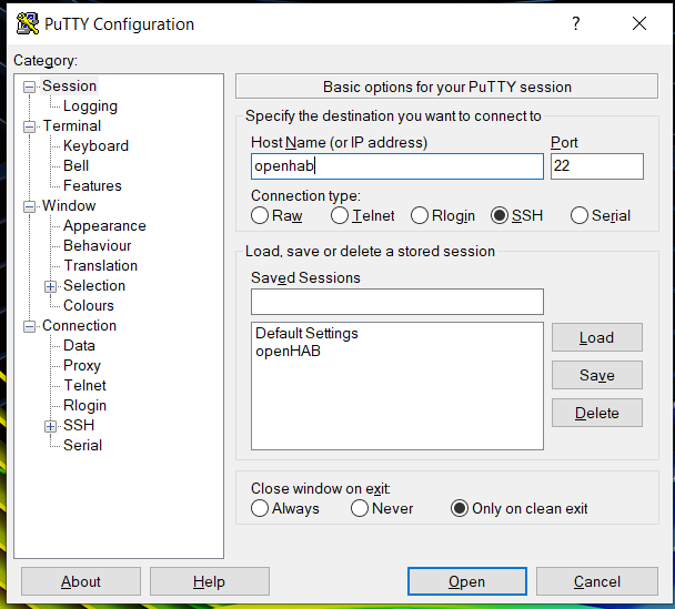

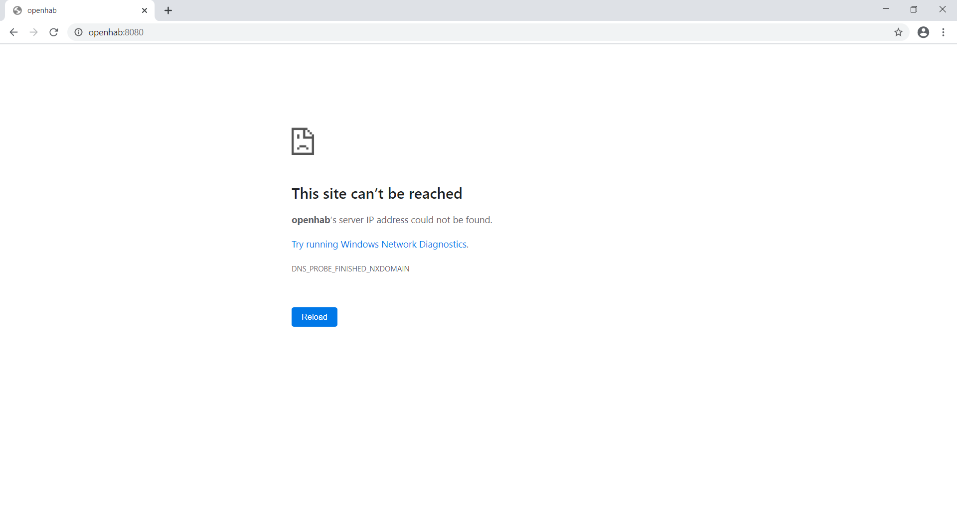

The other day I could log into my openhabian via PuTTY fine then today when I tried it, it just says “Unable to open connection to openhab Host does not exist” when I did the exact same thing as last time I logged on. I checked the hostname on my Raspberry Pi and it says openhab. Also on my Raspberry Pi it says “Then openHAB dashboard can be reached at http://openhab:8080” but when I go to that link it doesn’t work even though the other day it was working fine.
It’s probably your router. Hostnames can be unreliable.

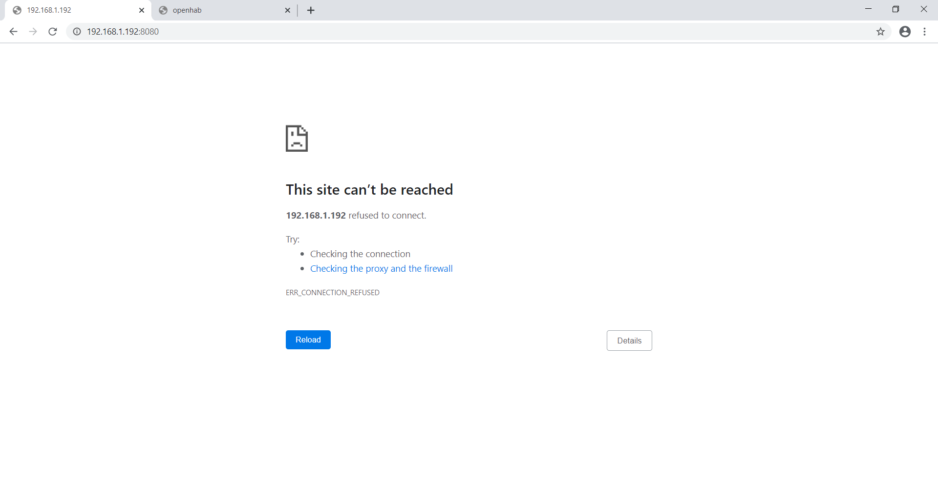

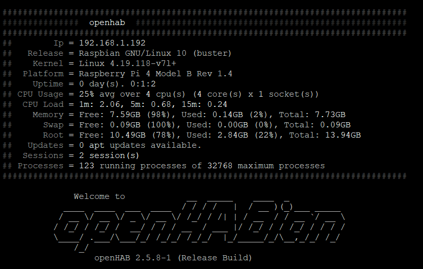

I reinstalled openhabian and now I can SSH in using PuTTY however It doesn’t work when I try searching the IP address or openhab:8080
How long is the host up since reboot ? Is it 1 minute and 2 seconds or 1 hour and 2 minutes ?
In case it’s 1 minute then the webservice might not be up yet.
