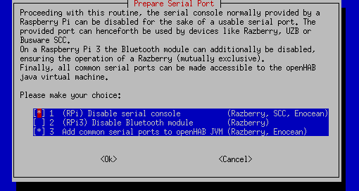

I have OH installed via openhabian image, running on RPI 3 B+ with SSD hard drive w/ no SD card. When I first setup the Pi with SSD I turned off everything else, Wi-fi, bluetooth, etc.. out of concern there may not be enough power. The Pi has been running great, so I decided to try @vkolotov bluetooth binding. While going thru the well documented instructions (thank you for that) found here https://github.com/sputnikdev/eclipse-smarthome-bluetooth-binding I hit a snag when trying to check my bluetooth version.
No big deal, I’ll use openhabian-config to re-enable bluetooth, wrong.:grimacing: After a few tries and reboots, the problem remained. After searching the forum I couldn’t find a solution so I started to google around. Most solutions were geared toward reinstalling your setup, something I didn’t care to do. An hour or so later, I finally had my buetooth back and working.

Make sure openhabian-config bluetooth is not disabled (no * at #2, again in my case,:roll_eyes:) at System setting > serial port
If you make a change here then a reboot is needed.

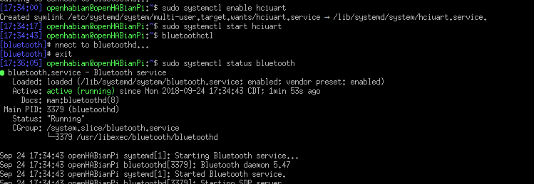

$sudo systemctl enable hciuart
$sudo systemctl start hciuart
After that check, your bluetooth again (using sudo systemctl status bluetooth) and you should have a screen like this, minus the part where I typed bluetoothctl.
It’s ALIVE!!:fireworks:
