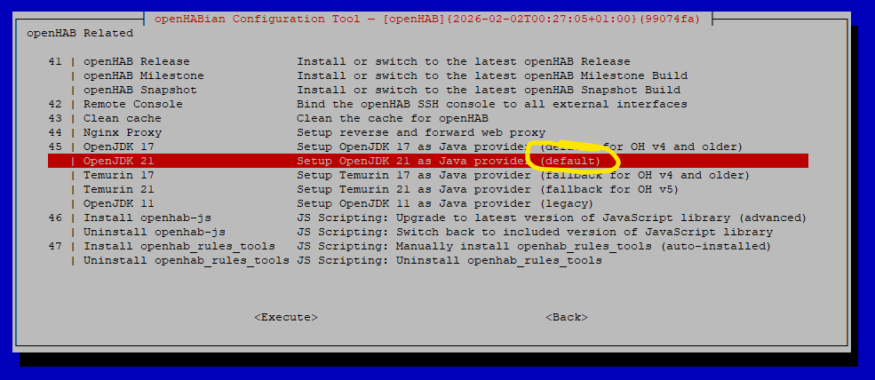

I am using Debian GNU/Linux 12 (bookworm) and recently switched my installation from Temurin to OpenJDK, based on the release notes stating “we’re back to OpenJDK Java 21 (it’s no longer Temurin)”.
Since then, the following message appears during startup:
Unsupported Linux release
You are running a Linux release that is not officially supported.
We recommend upgrading to the most current stable release of your
distribution (or current Long Term Support version for distributions
that offer LTS).
Is this message expected or intentional in this context, or is it more likely a bug?
The release notes are for the trixie image. They don’t apply to you when you’re still on bookworm so what you get is to be expected.
