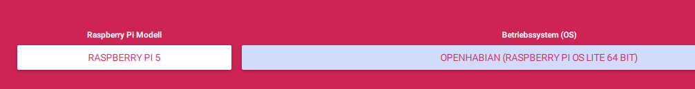

I just flashed an SSD with Raspberry Pi Imager using the option ā€œRaspberry Pi 5ā€ and "Openhabian (Raspberry Pi OS Lite 64 Bit):
Unfortunately, boot fails with message ā€œThe installed operating system does (OS) not indicate support for Rasbperry Pi 5ā€¦ā€
Am I doing something wrong or is there a wrong image behind?
I’m running on a Pi5 with 8GB.
Yes: you did not read the docs. SSDs are still unsupported as they have been ever.
and please consider that you won’t get bookworm when using raspberry imager yet.
This happens after we have the next full release (which should be soon…).
If you need assistance in setting up openhab on Pi5/bookworm/SSD let me know.
Oh right, I had forgotten about that. Thanks for the reminder.
@Thorsten_Witt your error message was because of that. You could try again with the imager. This time import the image from Release openHABian v1.9 Ā· openhab/openhabian Ā· GitHub .
