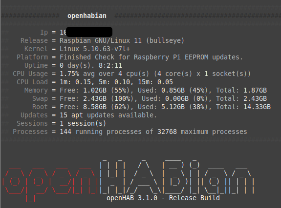

What command will trigger Openhabian welcome screen and where Openhabian gets that IP address on welcome screen from?
Afaik, the welcome screen is generated using FireMotD, so anything related to in here is provided by FireMotD.
FireMotD is running as a service in the background. The service is running randomly between 0:00:00 and 5:59:59. During that time subset of parameters are collected. The IP address is part of that collection.
The collected data is stored in /usr/share/firemotd/data/FireMotD.json and displayed together with updated information that is collected during execution time ( login time ) of a user.
You may check the content of /usr/share/firemotd/data/FireMotD.json it shows when the IP address was collected.
