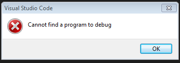

Which extensions should I install in order to debug my openhab configs: rules, sitemaps, items ?
I have pointed to openhab2 - conf folder already. When selecting start debug I being asked to select environment.
Selecting Node.js giving me this error.
Choosing option “More” asking me to select extension to install.
Installed the following extensions so far
You can’t use debug option for openHAB.
The only extension needed is openHAB, though there might be other helpful extensions, for example jsonpath statusbar, which helps to analyze json files and to find the correct path to a value.
You’ll have to configure the openHAB extension to get access to your openHAB server (not only a samba share for configuration files but also ip and port for LSP server and rest api to provide autocompletion and error highlighting.
