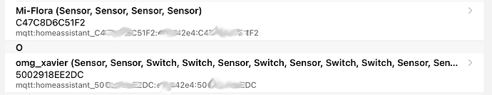

I wanted to go back to square one so I removed the things and flashed a different M5stickC.
I configured wifi and MQTT server, and left the default topic as āhomeā
when it came up I had two discovered āthingsā in my inbox:
When I add the omg_xavier item, I get lots of errors in the logs:
