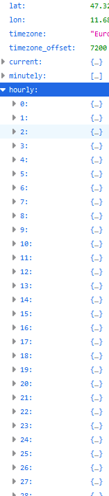

The free api provides 48 hourly forecasts, and indeed a request via the webpage using:
https://api.openweathermap.org/data/3.0/onecall?lat=0&lon=0&appid={myAPIkey} contains 48 hourly forecast fields, ranging from 0 to 47:
This used to work with the old 2.5 version of the binding: I defined 48 items to store the different forcast values.

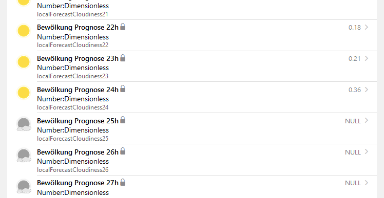

However, the openhab binding 3.0 only receives 24 hourly forecasts, the items form 24 to 47 remain NULL.
I would like to use items like:
{ channel="openweathermap:onecall:api:local:forecastHours25#cloudiness" }

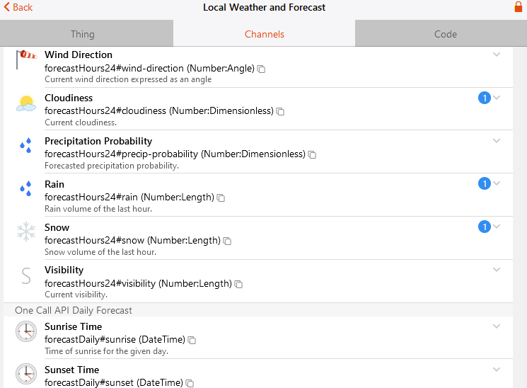

Looking at the thing in mainUI, the list of available channels stops at 24, channels for hours 25-47 are no longer available as they used to be:
Thus a question: is this an intended behaviour or am I doing something wrong?
