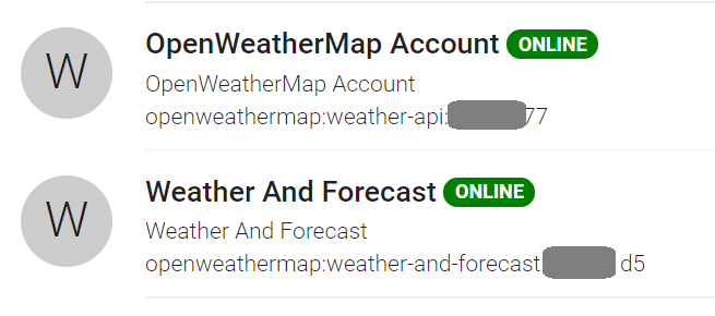

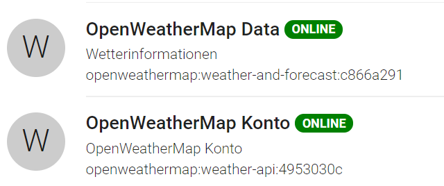

I created my a openweathermap.things myself (I come from Openhab 1.x and was used to create alle files myself at that time). Things became visible in Paper UI like you described however without Thing ID.
Now removed my Thing-file, Things in Paper UI and the openweathermap binding. Restarted my system and installed the openweathermap binding from scratch. Created new things:
The thing ID of both things is not the same. Is that correct?
I used the thing ID from the Weather And Forecast thing.
I do have Current Weather data in my openweathermap.sitemap (a temporary sitemap copied from your example). But no Forecast nor Graphs with data.
It’s weird that both Thing IDs are different. Are you sure that you didn’t use/define the OWM account elsewhere?
Please use the Thing ID ending in “d5” and report.
I already did and “d5” didn’t work at all.
I deleted and recreated the things for another time but they don’t work anymore. Today i don’t have that much time. First gonna try to create them again with the same Thing ID.

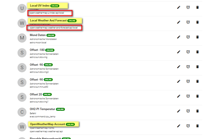

EDIT:
The red marked Part is what you can copy in your item-channel-information.

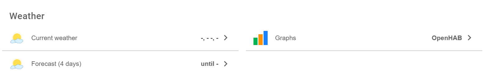

I downloaded both files, copied the sitemap and replaced the “77xxxx” in the item file.

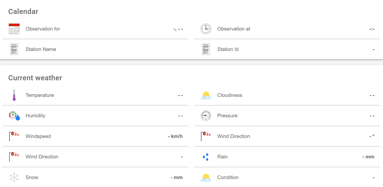

No data / values show in the sitemap…
How can I troubleshoot this?
some success… I forgot to remove “local” from the channels in the item file, since my things weren’t created manually.
Now “Current weather” has data!
Still, NO data in “Forecast”… ???
Forecast data appeared after some time as well !!
