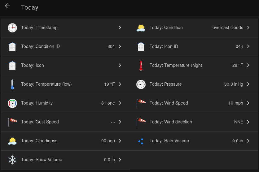

The OpenWeatherMap binding can be used with a free API, but this does not provide daily forecasts. So, I wrote a JSR223-Jython rule using the openhab2-jython modules to take the hourly data and add/remove the Items into groups that provide the daily forecast information. Since there are about 600 groups and Items that are needed, I included their creation in the rule too. The script file contains more details.
I think this is pretty much final, so I’ll start working on a Habpanel widget!
