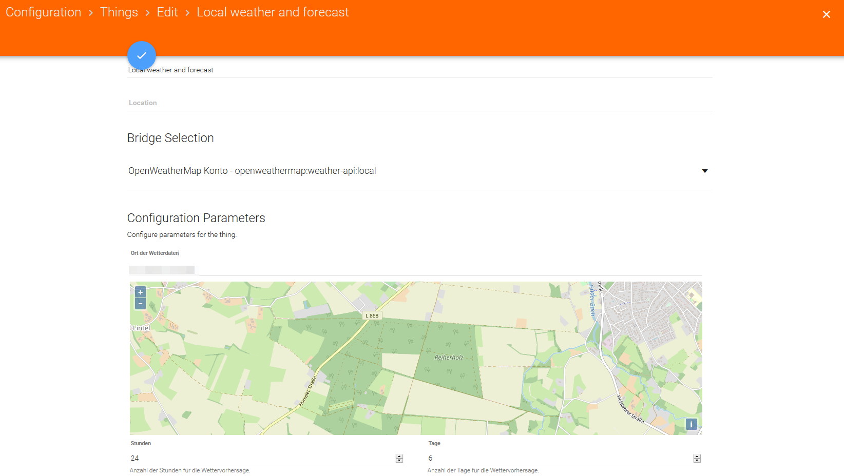

Ok, what about a screenshot ?
Tomorrow :grinning_face:
Actually it is not needed because everything was autodiscovered.
:+1: thx
Here you go:
There is no “forecastToday” if you have the free API key. I have the free version and I do not have those channels either. That is also being described in the documentation:
" Attention : The daily forecast is only available for paid accounts. The binding tries to request daily forecast data from the OpenWeatherMap API. If the request fails, all daily forecast channel groups will be removed from the thing and further request will be omitted.

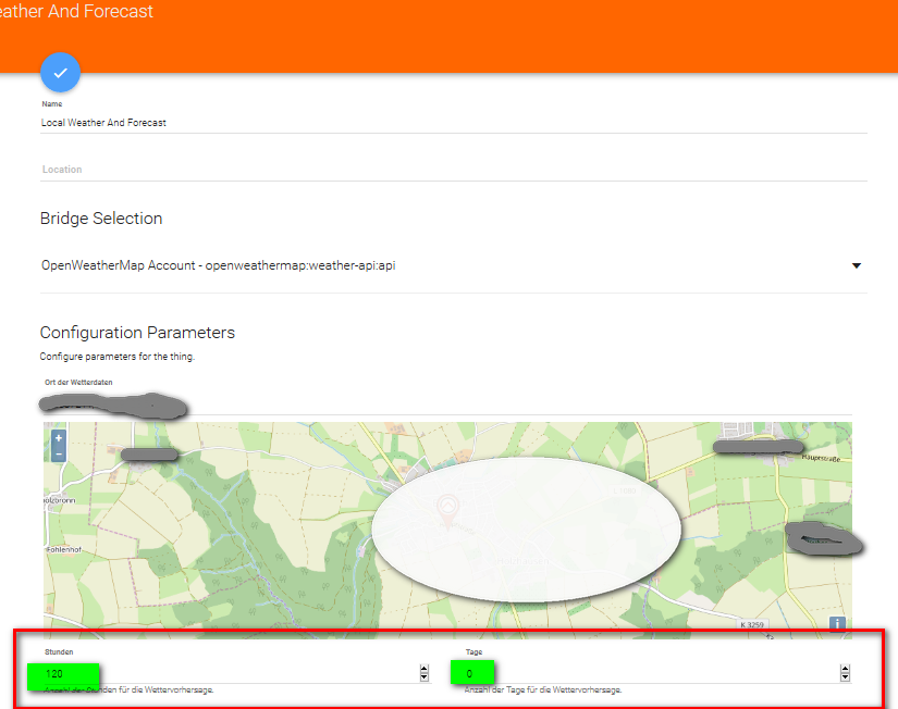

But if I change the 0 value in the local weather settings:
then the thing changes its status:
'openweathermap:weather-and-forecast:c8bf6942:local' changed from ONLINE to UNKNOWN
At the same time, Today Maximum Temperature and Today Minimum Temperature channels appear!
If i change the value back to 0, then this does not help, the status remains “unknown”.
After a reboot, the value of “Number of days for daily forecast” automatically returns to 0.
And also the channels of maximum and minimum temperatures disappear.
What is it? Binding error? The server provides the necessary data, even with the free APIKEY. I conclude that there is some kind of binding problem.
You mean, you try to set for Daily forecasts and it doesn’t work?
Yes, that is expected for free users.
For free, you can get the data in three-hour chunks (for a few days ahead).
This might clarify -
Also -
Not what you think -
Thank you. It explains everything.
