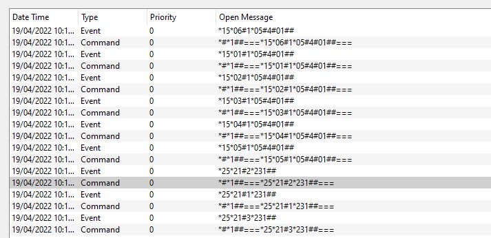

perhaps try to use the openwebnet client software, there you can log the commands and see what is sent.
for example an cenplus:
*25*21#2*231##
21 means short_press
2 means button nr 2
231 means cenplus 31
or for cen:
*15*06#1*05#4#01##
06 means button nr 6
#1 means release after short press
05 means cen-nr 5

i think you missunderstood. you dont need to send my examples. you only need the own client to watch the bus. send a cen command (that you need to know the button nr) from your device. watch the own client for a command starting with *25* (for a cenplus, as in my first example) or starting with *15* (for a cen, as in my second example). then you should see the button nr in that line how i explained.
