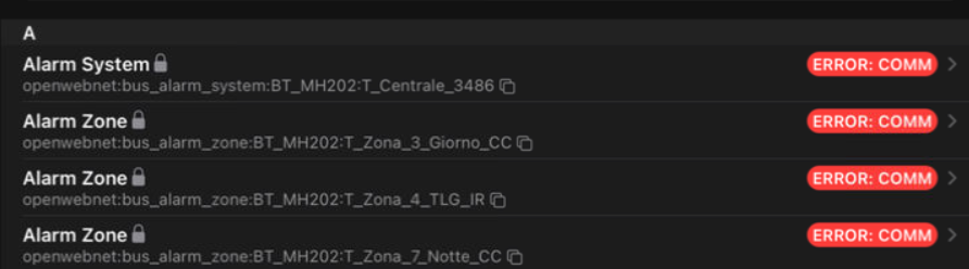

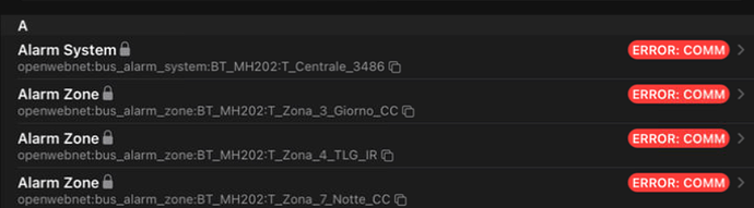

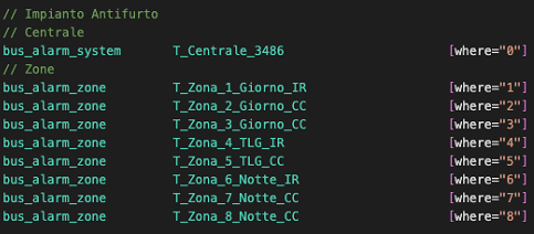

hi all, I’m hanging up on this post… given that I’m using the latest updated version of openhabian, I’m sure that in the “past days” the anti-theft device worked, while now it doesn’t work anymore… it doesn’t I changed nothing in the configuration. I have tried both using F454 and MH200 as gateway.
I am attaching configuration and error screenshots,
thanks for the support
grazie
“it doesn’t work anymore” and without logs are not enough to even start to understand what the problem could me. Be more detailed in describing what you expect and what it does not work for you, and provide debug level logs to show what is going on
