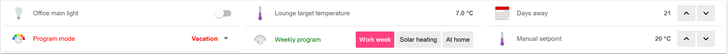

Vacation (Holidays on 3550) sets all zones to frost protection for a set period, set via Days, and returns to the weekly program at the end of the period.
Holiday runs the ‘holiday’ program for a set period (not set by days ) and returns to the weekly schedule at the end. Holiday program is a 4th programable weekly schedule and not available in the weekly mode list of 3 programs, I think it is intended for when you are holidaying at home. For the holiday mode the period set is the current day plus 1 for holiday!! Which makes no sense. I would have thought it would take the Days parameter like the vacation setting does.
When making the settings on the 3550 neither Holidays/Vacation or Holiday, which use calendar date, are reflected in the binding Days setting. Seems it is only used when setting Vacation mode time period.

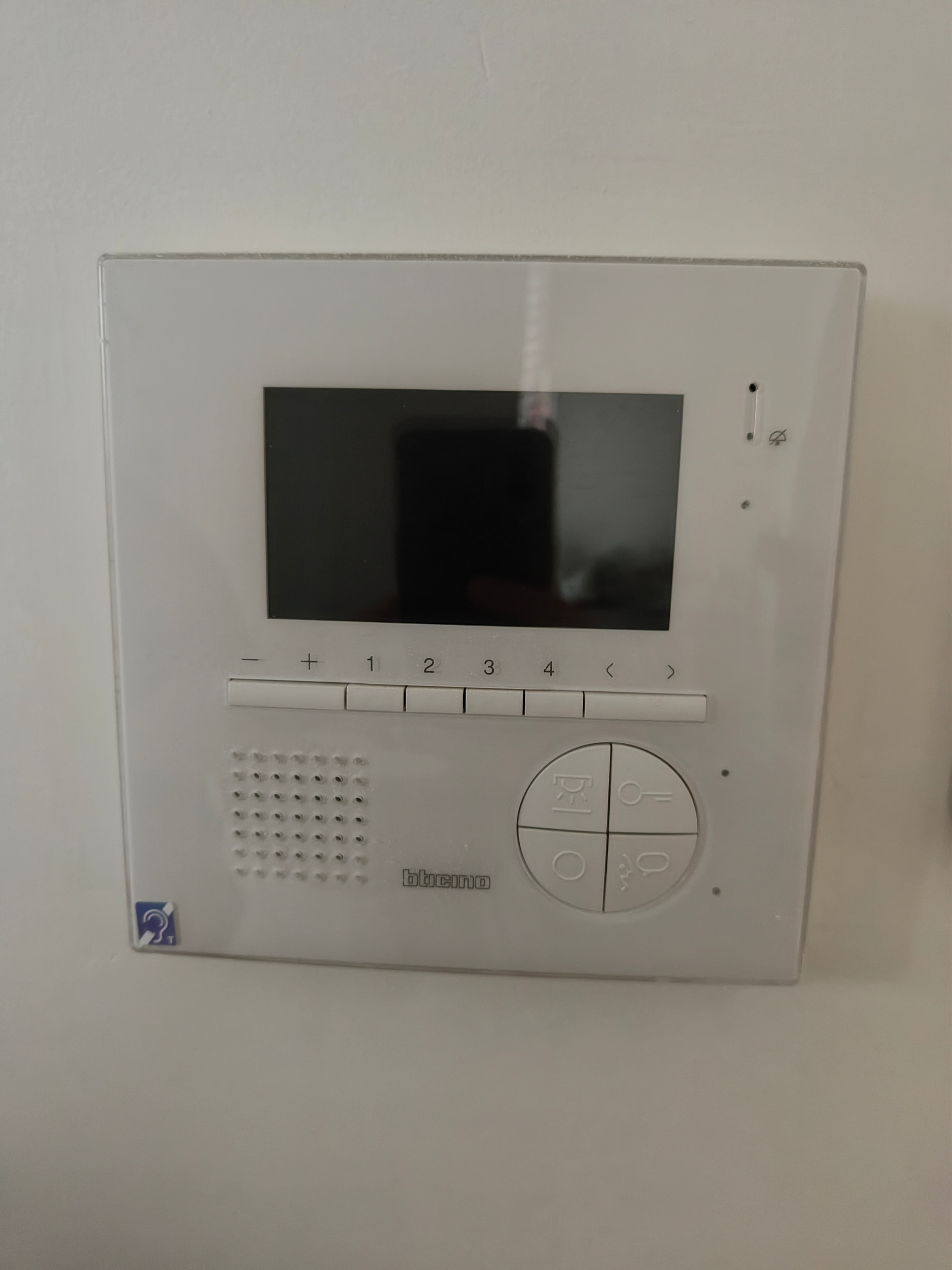

i do not use bticino video station. but when i search i think it could be a Bticino - VIDEO CLASSE100 V12E ELEGANCE and i suppose it will not be possible to integrate it in openhab.
Would be nice if it was integrated in the binding. It was something I asked for a long time ago during the active development phase. Massi was too busy with more important integrations. .
I have classe 300 video door entry. Would be good to use openHAB to alert me to answer machine messages, date/time when the door bell was used etc.

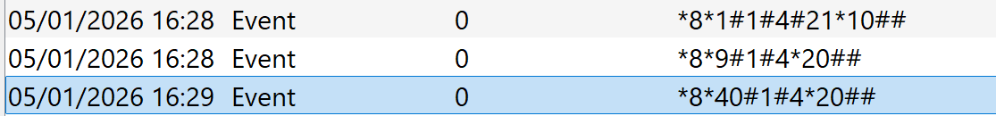

When the door bell is pressed I get these warnings >>>
2026-01-05 16:28:59.287 [WARN ] [nwebnet4j.communication.BUSConnector] - ##BUS-conn## INVALID FRAME RECEIVED ON MON: `*8*1#1#4#20*10##`, skipping it
2026-01-05 16:28:59.291 [WARN ] [nwebnet4j.communication.BUSConnector] - ##BUS-conn## INVALID FRAME RECEIVED ON MON: `*8*9#1#4*20##`, skipping it
oh, at least there IS a bus event, thats promising
poor i do not have any informations about who=8. and i do not know which door stations are able to generate bus events. for example the classe100 noted a post above?
