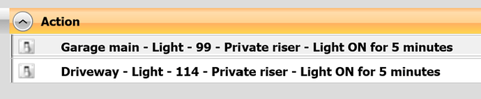

Caused by MH202 scenario with these actions
2 >>>> After network rebooted or MH202 rebooted.
