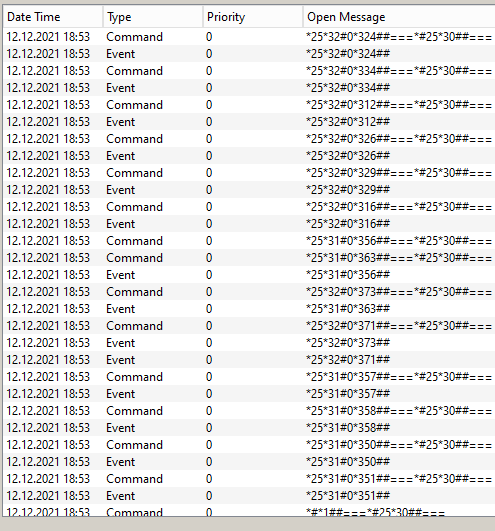

as long as i do not reboot the contacts seem to work as expected when switched.
if you ask state using the OpenWebNet client using this message:
*#25*30##
what is the answer?
this look like more as a OH Marketplace problem.
I suggest you move the RaPi to snapshot for the moment and leave the Marketplace until 3.2 is released.
strange, should work, didnt know this command but seems to ask for all states with one command.
but seems not to work at boot, not just one contact comes online.
sorry i dont understand. do you mean i should download the *.kar file from git and put it in addon-folder? (this i did before, not quite sure but i think i had the same problem then)
side note: i realize that when i send *#25*30## not all contacts answer the state. i receive feedback from 32 contacts, but 7 dont answer, even not when sending the command several times. cannot see the 7 contacts have any common,

so when OH boots: 32 contacts become online and their item state is updated, only those 7 remain offline and linked items remain “unknown” ?

i am not at home at the moment so cannot test again but i realized before that not one contact comes online when reinstalled the binding from marketplace. so i tried to send the own command manually from own-web-net client. when sending *#25*30## many but not all contacts come online. but when asking this contacts direct, for example *#25*354## then it answeres the state and comes online.
Ok then I suggest you do more tests with the official 3.2.0 due Dec24th (or 3.2.0.RC1 already available if you do not want to wait), and skip for now the Marketplace version that may have some problem at the boot (even if my code is the same)
now i uninstalled the marketplace version and installed the 3.2.0rc1 as suggested.
all contacts work as expected, they are found and all state requests work now.
only on reboot it takes very long until the states are reported (or lets say until they come online), it takes about 6 minutes. all other items are online within the first minute. so meanwhile all rules are loaded and when they need an contact-state they dont work properly.
