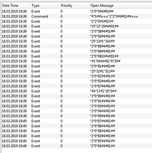

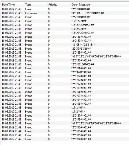

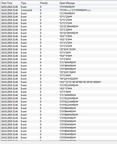

in amb=9 i have eight rollershutters
now i see with the automation gen-command two of my actors are replying,
58#4#01 and 59#4#01 (that is garade-door and yard-gate)
command 21*0#4#01##
aaaah, attention attention, now i see the commands you are searching for:
i didn´t wait long enough, this entries are not already logged when the shutter starts, the are logged when it receives its end-position.
this was logged with f454, next test will be with mh200n
now the own-client log with brigde mh200n
command “up”:
and command “down”:
