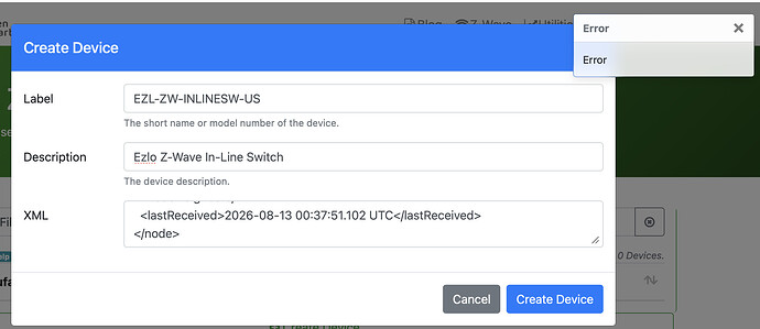

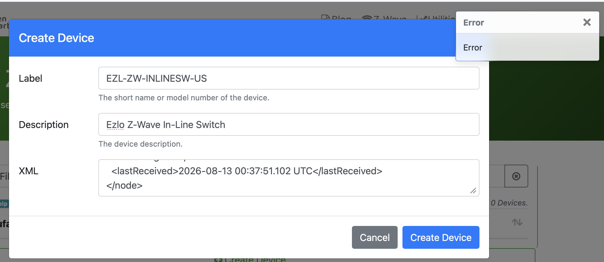

Is anyone else having trouble adding devices to the Openzwave Database? When I try to submit a device with its XML file, the site just displays an Error message with no details.
It could be a device with the type:id already exists. Also sometimes a new channel not in the binding
I searched for the device by name and hex. I don’t think that’s the issue, the error message looks odd because it’s just blank. Doesn’t indicate “duplicate item” or anything like that. See screenshot below
Posting my node definition here in case

The developer tends towards brevity in logging :wink: . Thanks for the XML, that would have been my next question.
The reason is the mfg code doesn’t exist. you’ll need to open a ticket and ask Chris to add it. From another source "0x025b": "AdTrustMedia LLC dba: eZLO"
@chris any chance you can help here?
I opened a ticket on the opensmarthouse site
